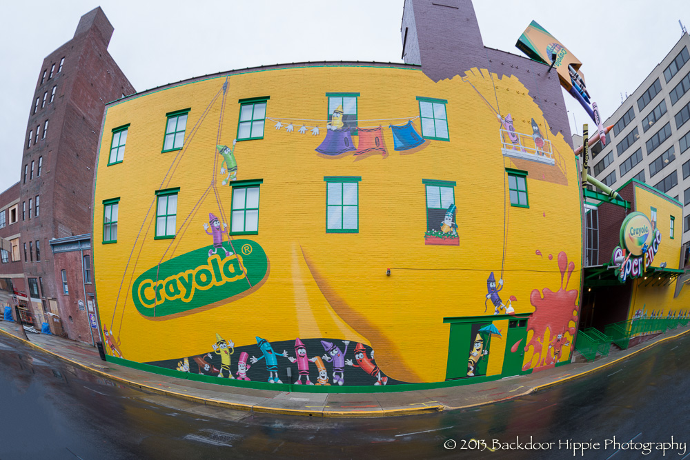

To give you an idea of what I'm talking about, here are 3 edits of the same photo.
Version 1 - Straight Out Of The Camera
As you can see, there's plenty of barrel distortion, and the 180 degree view on the horizontal is fairly easy to see (I was about 12-15 feet from the wall).

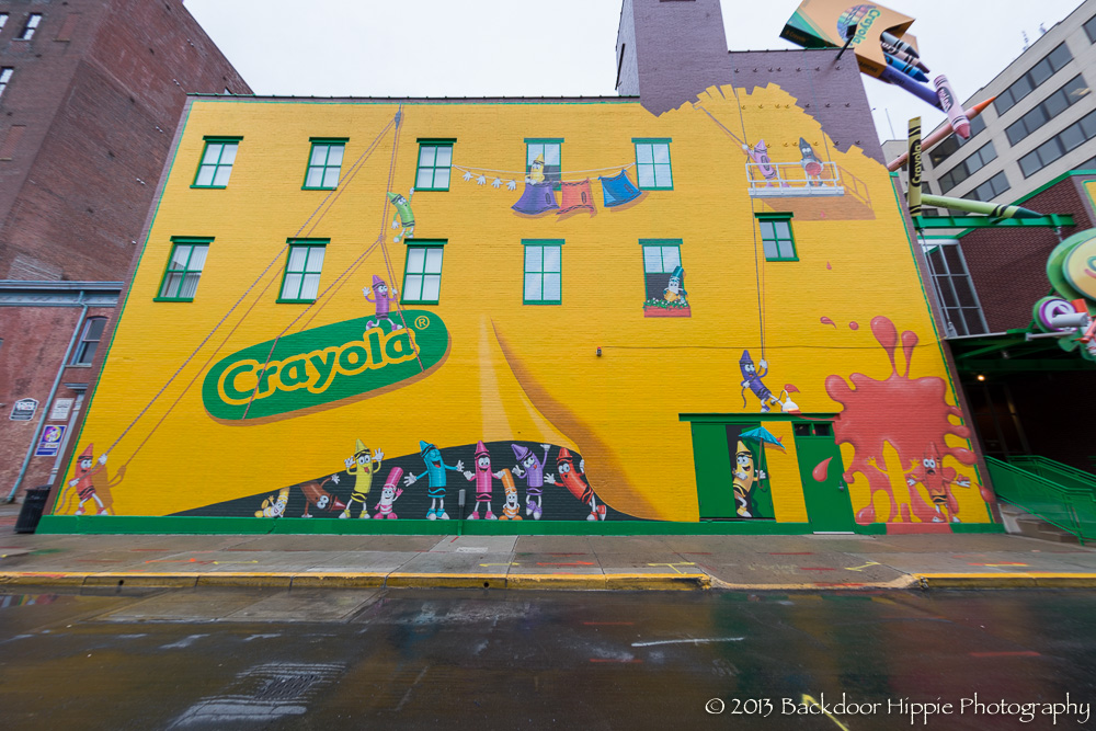

Version 2 - Same Photo with "Auto" correction for Vertical & Horizontal skewing
This is kind of cool and allows for a lot of options with shooting architecture provided you provide room for cropping. With that in mind, I decided to see just how good Photoshop's Content Aware Fill did with the open areas, so I selected them one at a time, expanded the empty selection by 3 pixels and invoked Smart Fill. I have to say, I'm pretty impressed.
This is exactly what Photoshop gave me, no additional touch ups.

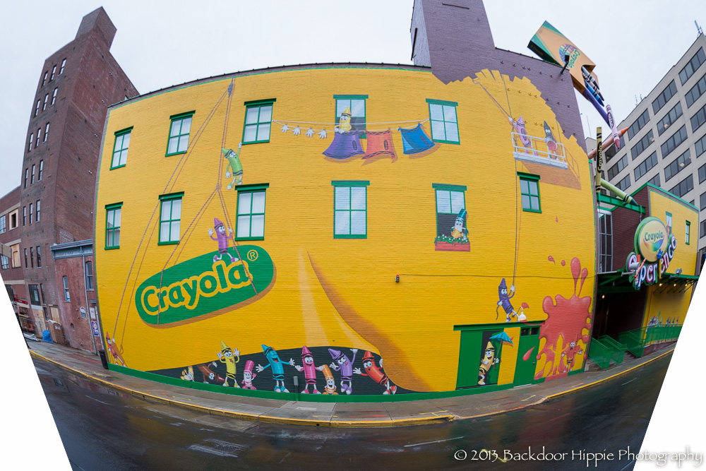

Version 3 - Original Photo with Profile Correction added
Here you have the rectilinear profile correction straight out of Lightroom. No additional horizontal or vertical adjustments. Essentially, this turns the fisheye into a 15mm f2.8 at the touch of a button. Pretty good job. And for giggles, I decided to also invoke the Auto correct to adjust vertical and horizontal lines. I have to say, I was slightly blown away by what I got...
That's a complete, 3 story facade from less than 15 feet away!!

Good! Perspective corrected almost completely, with losses in both axes being quite acceptable. Corners are kinda softer, but it might be normal with such a wide angle (or is it just a consequence of a correction?). Good lens, anyway.

Looks like a very fun lens Jake. Curious, so the final shot of your first post was corrected only in LR?
Also were you shooting at 2.8, wonder if the corners would sharpen up at f8.

Outside of the content aware fill that I did in PS, the only edits on the shots in the initial post are LR corrections in the Lens Correction module only, and then it was just a matter of hitting preset buttons and not using any of the manual correction sliders.
Prior to getting this lens one of my default corrections when pulling things into LR was to invoke Lens Profile Correction and Chromatic Aberration Removal. I believe in the street shot I may have ignored the latter when I ignored the first. I've since processed several others and LR does a fine job of getting rid of the CA distortion in the corners. The photo in question was shot at f8 actually. Here's another similar shot. It had bad CA in the upper left corner until I checked the box in LR.

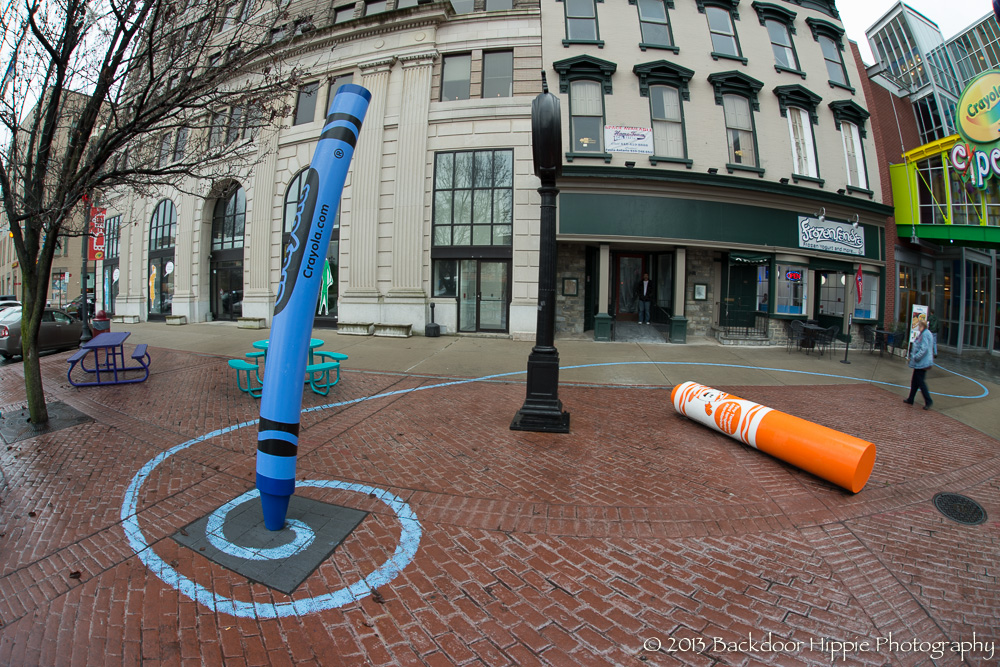

And since I'm posting examples, here's another shot taken yesterday. This has the Profile Correction option invoked...
It was post processed using CS6 (light levels and sharpening) and Nik Viveza and Analog Efex. I really like what Analog Efex does with a wet cityscape. Here's the unprocessed before photo straight out of the camera...

It looks like the profile correction is softening the corners more than the lens itself. It would be interesting to see a corrected image from this lens compared to 16mm on your 16-35.

It's not so much softening as stretching. If you look at the amount of horizontal room taken up by the window in the upper right corner and compare it to the same window in the original photo you can see there's a lot of interpolation going on here. The more details there are to stretch the less sharp it will appear. Were this a monochrome wall or something will less detail I it wouldn't seem as soft. And to be fair, the use of Analog Efex here may have introduced some additional noise. It's by no means a substitute for a lens that does the rectilinear correction itself, like the 16-35mm, but the idea that LR does the correction at the touch of a button is nice.
You can see the same type of softening in the Crayon box in the upper right corner of the finished image of the Crayola factory from my first post here in this thread.
