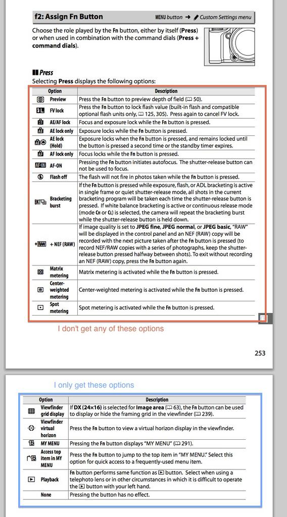

I am trying to assign my Fn Button to be the FV lock so I follow the instruction in the D7100 menu -page 253.
But the option I get when I go to Menu->Custom Setting->Controls>Assign Fn Button, the selection I get is nothing like what is shown on the menu. None of the options are there except for the last 6 item.
Assigning the FV lock function works using the Assign Preview Button. Of course I would lose the use of the Preview Button for preview. Anyone see the same thing on their D7100?

Simple problem - I tried to assign my Fn button on my D7100 to be the FV lock button. So I followed the instruction on my manual page 253. The problem is the first 13 items of the list of options do not exist on my camera - only the last 6 which does not have the FV lock function. So, this is what I get from Nikon:

Ok, so Nikon's got a problem. I went to the camera store where I bought my camera and ask to see another one and compare. Guess what - it behaved the same way as mine - ie the Custom Setting Menu to assign functions to the Fn button do not have the options as listed in the manual. I ask to see their manual and it's the same as mine. Just to make sure I have enough data, I went to a very high-end Full Service camera store next town over and ask to see a D7100 - and lo and behold, it too has the same 6 options for assigning the Fn button - not the 20 listed in the manual -and FV lock is not one of them. So, either Nikon needs to send out a firmware update or their manual is wrong!
So, if you have a D7100, check to see what options you have to assign your Fn Button and compare them to Page 253-254 on your manual.

I didn't see all 20 options in the menu either at first; in fact I was only seeing four options. Then I scrolled down and once I did the menu "expanded" and a scroll bar appeared! Ah-ha! From that point on all 20 menu items appeared, including FV Lock, exactly as are shown in the manual. It also works if you scroll up, past what looks like the top of the menu.
It's worked the same for me a few times now so I'm thinking this is a some kind of menu-display error that could probably be fixed with a firmware update. Of course that will be up to Nikon.

I have assigned the FV Lock to the fn button with no issues.
For this I am in P mode.
firmware C 1.01, L 1.009
So
1. Menu
2. Select Custom Setting Menu
3. Select f.controls
4. Select f2 assign fn button
5. Select Press
6. Select FV Lock
Now look through the view finder 1/2 depress the focus/shoot button and press fn. nothing happens....pretty much as expected given the flash is off.
Press the flash button to raise the flash, focus again then press fn. you will now see the FV Lock icon at the lower left of the viewfinder.
Pressing fn several times and you'll see it go on and off. Leave in on then press the info button to read the LCD.
As far as I can see, there's no indication here nor in the small top info screen that he FV Lock is set.
Now press Lv to switch to live View. You will see the FV Lock icon at the very bottom left of the preview screen. Press fn to switch it off....the icon disappears. Switch off live view and you can confirm that the FV Lock is off in the view finder
What I can say is that you can only set the FV Lock on using the fn button when using the view finder but not when using Live View.
