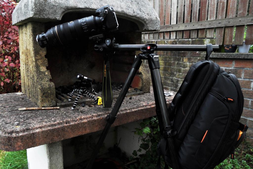

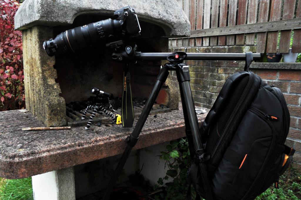

I hope you do not mind me sharing my experiments here, I thought of starting this subject: I use a 77-77 male male connection. Reversed is the 52mm full open with a bunch of step up step down rings brings it to the 70-200mm.
Here is the try this weekend to get a spider with a body of about 2mm long (needed a large magnification to see something):

If you really want to try, then don't give up. It is a bit hit and miss but when it falls for you the result is worth the effort. Focusing is the hardest part but don't waste time trying to hold the perfect position. As you move in and out, hit the button every time it seems in focus. You may get one good shot in 20 or 30 but that one will be worth the effort.
If you are trying to photo insects or spiders then a tripod is out. It takes so long to set up that your target will either have moved away or died of old age.
