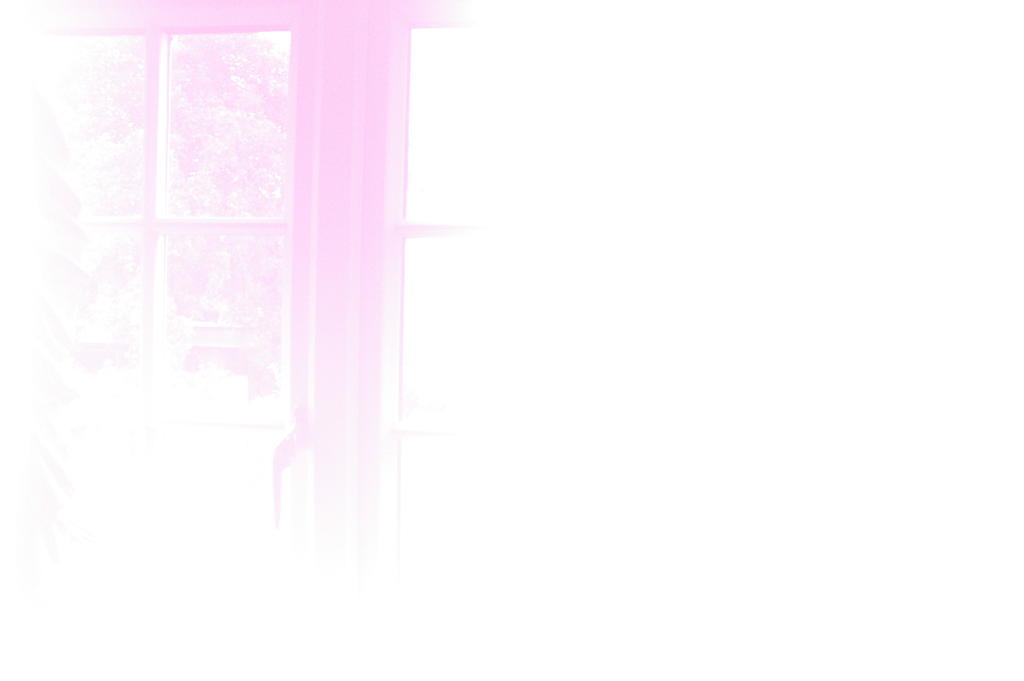

Just bought a D70S from a friend. Every pic I take is a blank white photo on preview. Hooked up to PC and it's blank white with a pink hue to some objects. I think it's an exposure issue. Tried the following to fix it:

Battery charging has fixed the PC connection and menu problems. The white/pink image issue persists. Managed to get a raw file for any tech savvy people to have a look at but i'm not sure where I can upload it because the forum attach file option is giving me an error. So for now all i can do is a JPEG

I pulled my 20mm f/2.8 AF lens out after not using it for a long time. The aperture is stuck and won't stop down which meant all the photos were overexposed (sent my lens in for repair). Does this problem happen with both lenses? You should make sure the problem is the camera body first. If it happens with both lenses, then it's probably a camera body issue.
EdView attachment 53148
Yes, your camera is broken. I don't know what is wrong with it since I'm not a camera tech, but it does not seem to produce great photos.
Just one thing before, did you also try in "Manual" mode? go outside, use iso 200, f11, 1/500s and then f5.6, 1/4000.
But from the looks of it, I would not buy this camera and if someone had sold it to me, I'd bring it right back to him for a full refund.

You've tried different lenses, different (charged) batteries, the camera is in full Automatic (though you've tried other modes as well) and you've done a factory reset. There's only so many ways you, as a consumer, can screw up a shot THAT badly without the help of the camera being broken and you've pretty much eliminated them all. If this turns out to be user error I'll eat my running shoes and post the video. I also find it really hard to believe this camera was taking great pictures, got handed off to you and now is producing shots like the one you posted. I don't know my friend but I'm going to say this one more time... I really think it might be best to simply undo this deal and go buy elsewhere.
