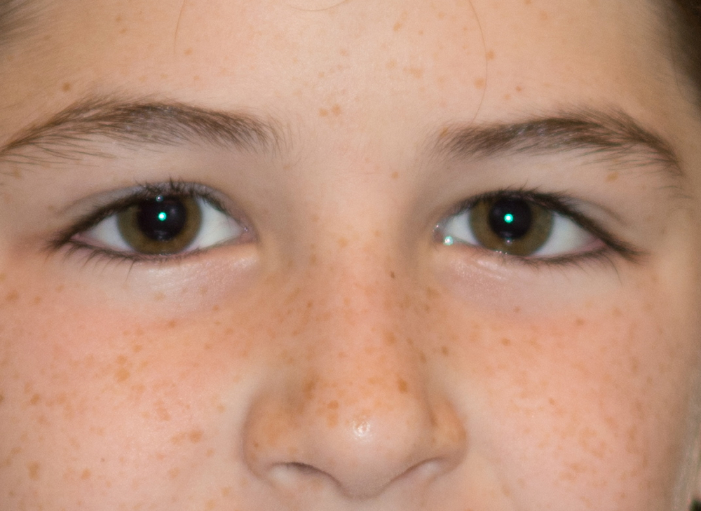

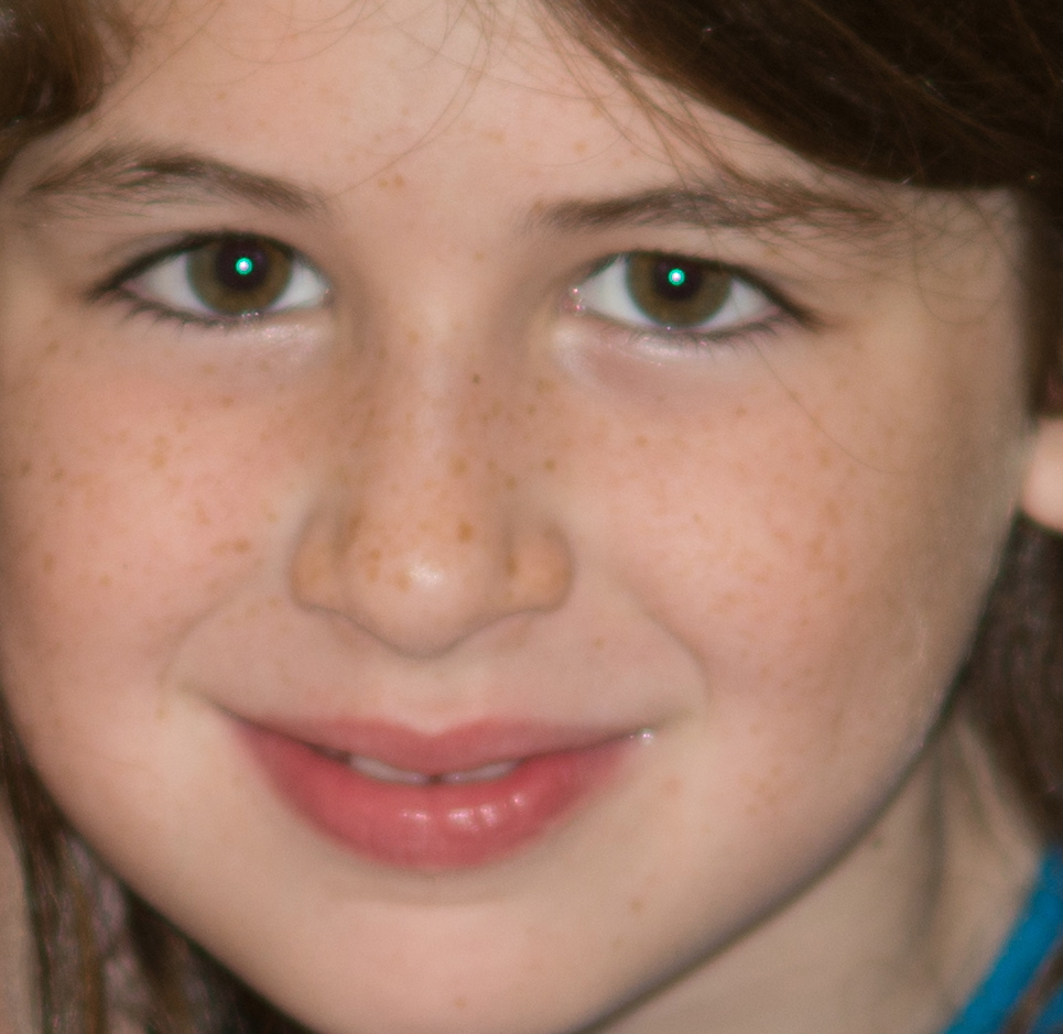

I'm adding 2 photos (cropped) with the problem. You can see the problem clearly when the photo is at maximum resolution (4000x6000) ; the eyes are blurry and very soft...
The same photo a few seconds before and later was OK, but I want to understand why I can't rely on my camera to have every time a nice, sharp, focused photo.

The scene : simple portrait with flash (indoor).
Please find the exif information for first photo :

Please find the exif information for second photo :

In looking at your shots I'd say there is definitely an issue there. Since you're shooting in RAW you do have to expect to sharpen in post' but those shots are definitely NOT in focus to begin with, not even close. I'm having trouble deciphering what your EXIF data is saying however... In fact I've never seen EXIF data that even resembles what you've posted. How are you extracting your EXIF data?

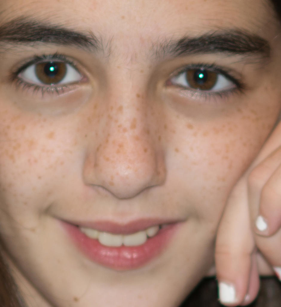

I made some more tests, and I can clearly see that I'm having those problem with aperture < 3.2
If my aperture is 4.5 for example, I got clear sharp photos.
When aperture is 2.8, I got most of the time blurry, noisy photos.
Does anymore shooting portraits with 85mm f2.8 have the same problems ?
I would appreciate if someone can post a portrait photo made with 85mm 2.8.
I'm attaching 2 more photos : the first with 85mm 5.6 and the second with 85mm 2.8.
You can clearly see the difference in sharpness.
