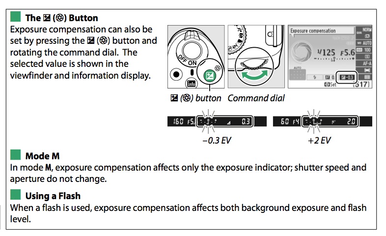

Have you tried adjusting the Exposure Compensation in 'Aperture Priority' mode for a little more light and speed? Cheers, Brad :)
