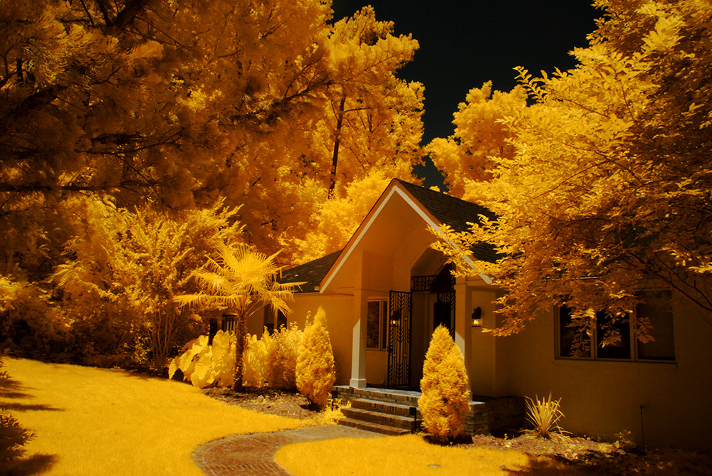

Here are some samples... most without a filter, but the one of my patio has the filter. The color ones had lots of channel switching in Photoshop. I highly recommend you watch all of the videos on lifepixel.com. They are very well made and give lots of good information. Beware, if you watch all of the you will probably buy something from them.
No IR filter:
Patio with IR filter

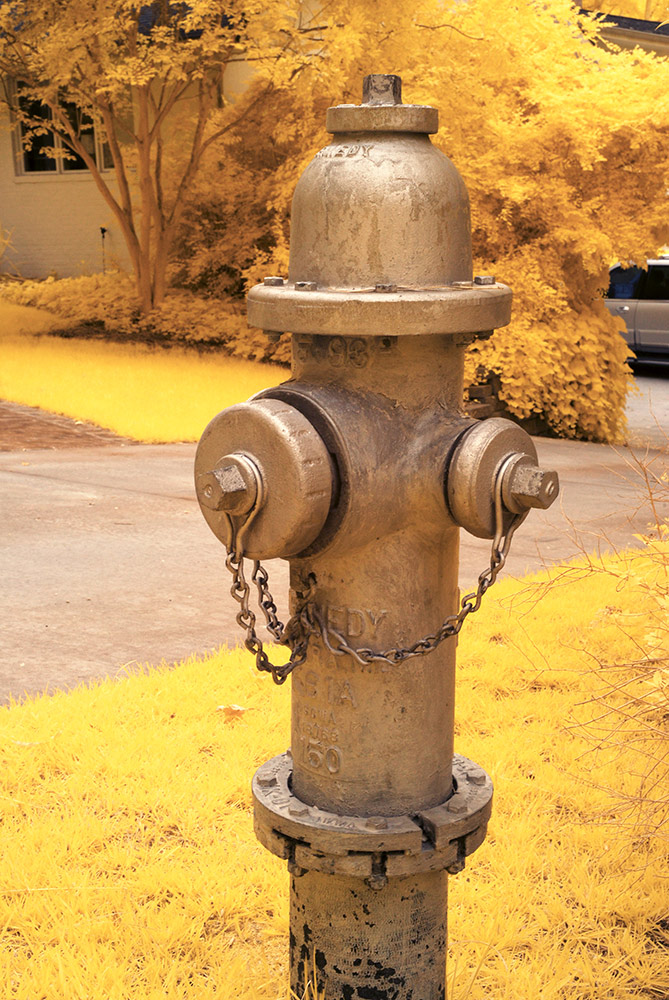

The head and knobs on this fire hydrant are grey, as pictured, but the body is painted bright red. It looks like the IR light passes through the paint.
