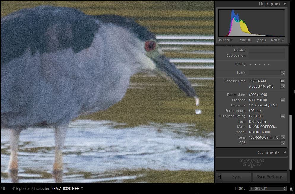

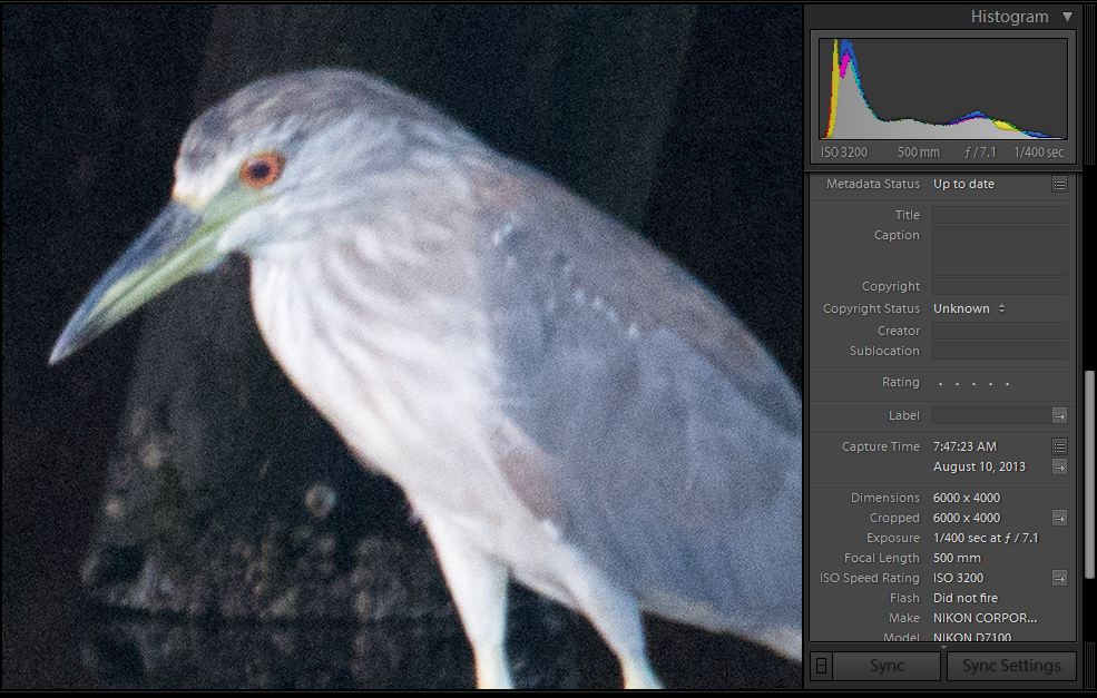

I finally got out this morning to take some bird shots with my 150-500mm Sigma lens on my new D7100. Typically the way I set it up is to Auto ISO up to 3200 in order to keep the shutter speed quick (around 1/800). As I understand it my D600 should perform better at the higher ISOs and that at ISO 3200 both results would be pretty grainy, but what I wasn't sure of is how far apart the two cameras would be in comparison. I'll admit I was a little excited to test the D7100 and see how it looked cropped in at 100%.
I didn't intend to do a comparison but when I uploaded the pics I was disappointed enough to look up some D600 pics from the same location around the same hour but months apart and compare. Because I wasn't intending to do a comparison this "test" is about as unscientific as it can get.
I don't consider any of these pics keepers but mainly chose them to keep most of the values close. All of them are unedited snippets from my LR4 cropped in at 100%
Here is a D7100 at ISO 3200:

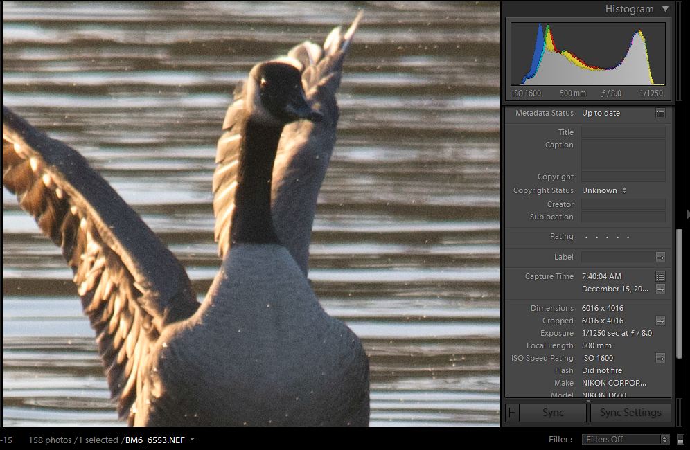

Here is a D600 image at ISO 4000:

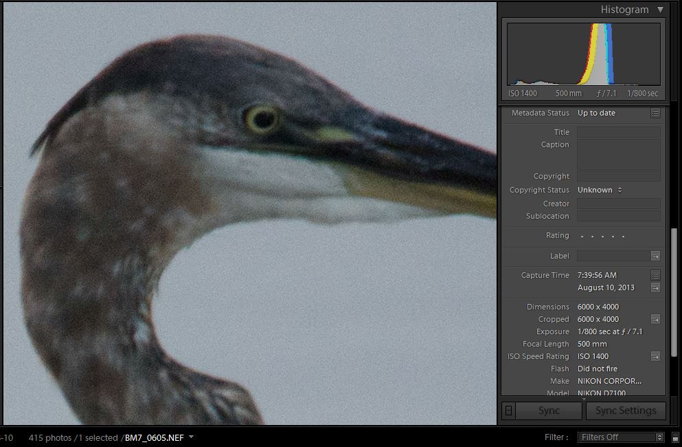

Here's another D7100 at ISO 1400:

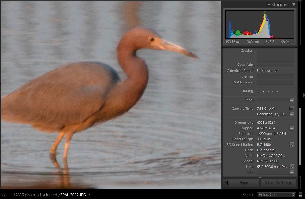

Just for kicks here is a D7000 image at ISO 1600:
