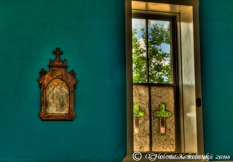

I completely agree with Eduard. Below is a shot of a church window which I processed in HDR because I wanted trees outside and the beautiful blue wall inside. Even if you think you don't want to do hdr, shoot (auto bracket) as if you would. I strongly believe in NEVER limiting your options. Let me know if you want to see the non-hdr photos of this window and I'll post them someplace else. . . don't want to bore anybody.

The photos I used are in my blog.

As you can see from the photos in my blog, the hdr process really made the photo.
