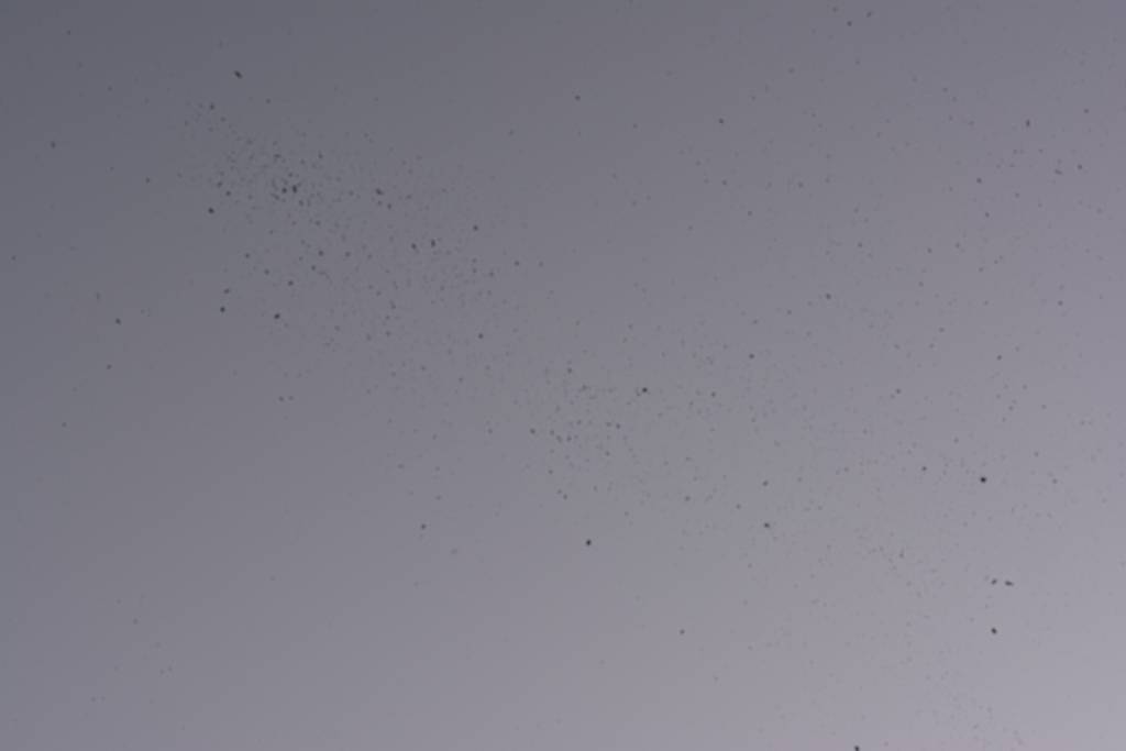

A couple of weeks ago I noticed a couple of dust spots on a blue sky shot at f16.
Yesterday I decided to get out my generic blower and see if they would move,,,, big mistake.
I ended up with about a thousand spots, not sure if they came out of the blower, or they were dislodged from the mirror box and ended up sticking to the sensor.
But woefully they ended up there. Here is a cloudy sky shot after trying the blower ( silly me didnt take a test shot before I did the blower)
Shot at f22.
