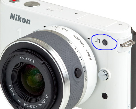

Just want to clarify, the AF assist beam on the J1 is green, not red like most Nikon's. When I half-way press the shutter the green beam appears, it is supposed to go away when the shutter is fully pressed and the picture is taken. I was just surprised to see the green in the picture, instead of orange or red.

I remember seeing the green spot in the viewfinder, as I set-up the shot, when I pressed the shutter the green spot stayed in the picture. Somehow some residual light got into the lens. The only thing I can think of is that my left hand got in the way of the light and caused it to disperse across the lens, the light is positioned in the top right corner, not an ideal location and my hands are big:
