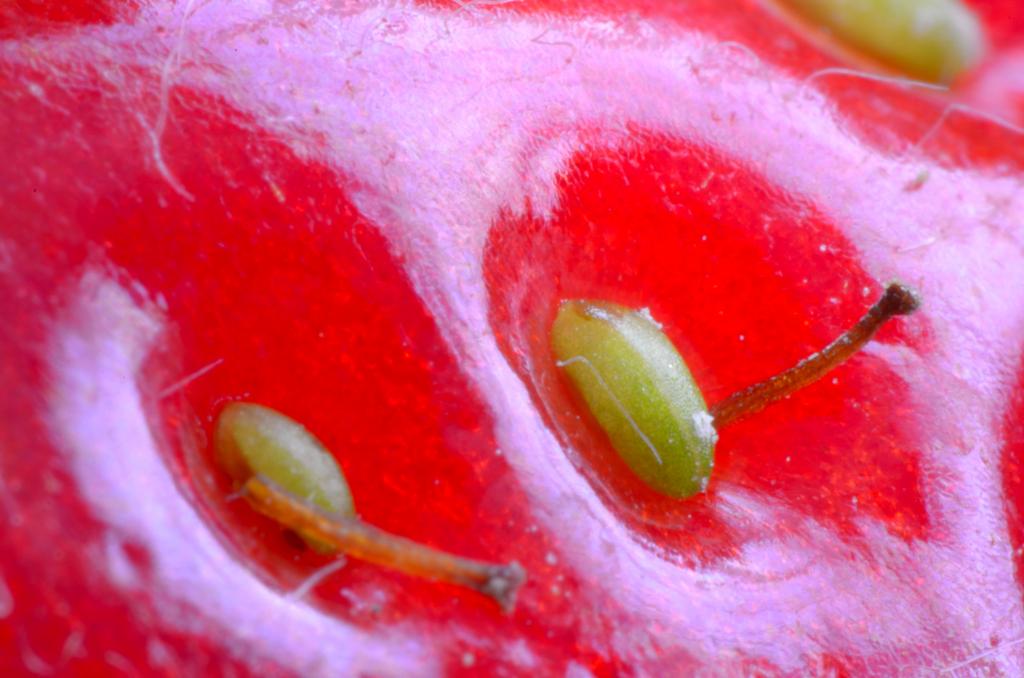

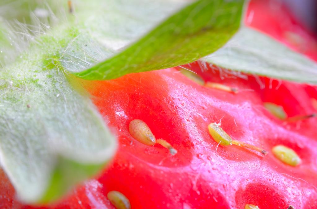

Or you could use a reversing ring like I did here.
This shot with a 35mm reversed.
This shot with kit 18-55 set to 18mm and reversed.
