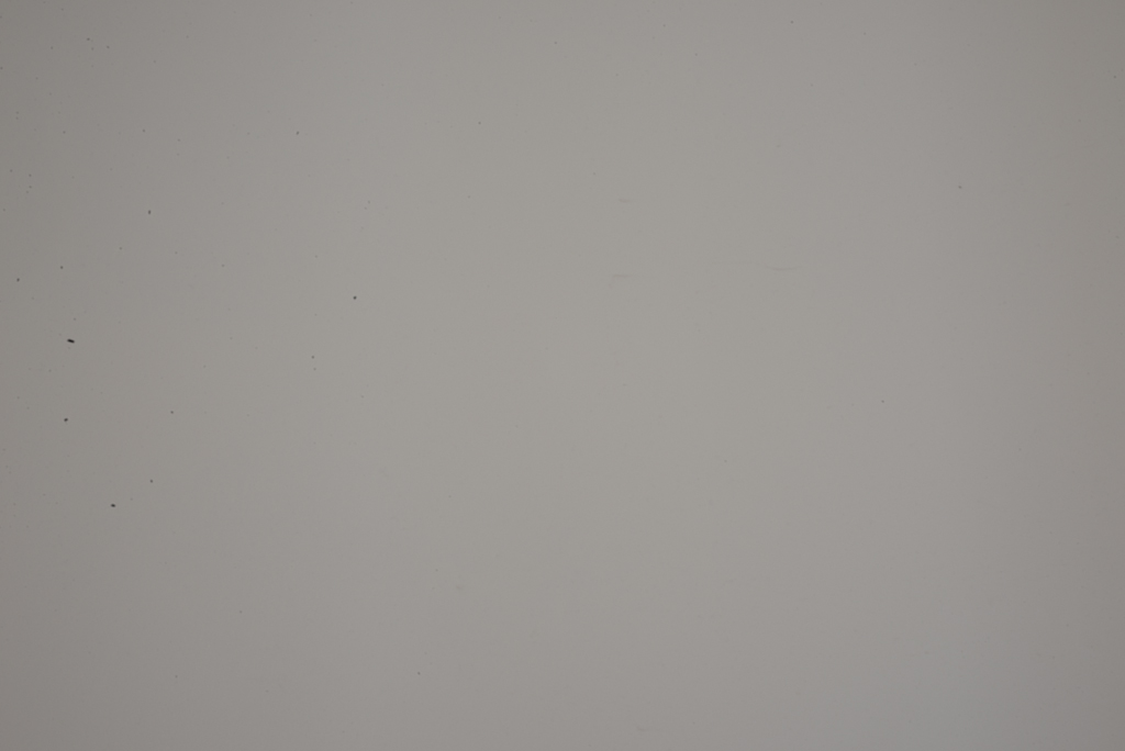

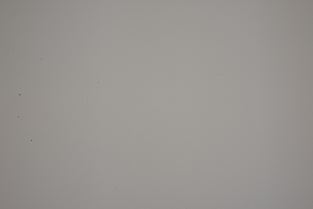

Only had my D600 for 10days and have noticeable dust on the sensor. :(
The clean function on the camera had no affect... i don't have a 'blower' yet, i assume i should try a manual clean, something that i have never done before or should i get Nikon to do it?
For what it's worth, while this looks like dust, it looks different from the dust patterns I've seen on my D600, and those of others who had this problem. Yours are fairly well distributed and outside the left corners, which seems to be where the spots on the D600 are really concentrated. I suspect some or most of those would go with the use of a blower - they look very similar to what I see on my D800 after a couple thousand actuations.

Thanks BackdoorHippie, i agree ala the link above.. looked through it and can't see anything relevant!
I contact Nikon they requested a sample image, I'll see what they say.
If its a warranty issue they said it was a 10 day turn around with free postage.. will wait and see. Only taken 1,400 shots.

Cheers mate, Nikon have responded
I have examined the image you sent and can see that there is artifacts on the sensor. However it is difficult to tell what may be causing this ( oil or dust) without first having it examined by a technician at the service centre. If it is caused by a manufacturing defect it is covered by warranty
Please return your D600 to the service centre.
I'll take your advise and get a blower today and see how it goes. I'm a little concerned with the wording; "If it is caused by a manufacturing defect it is covered by warranty" but hope that is standard for any issue.
​Being such a new toy i have obviously been very careful with it and have yet to use it in a dusty environment.
Lets hope a blower sorts it out.. but I'd of thought a blower would just blow the dust around!
