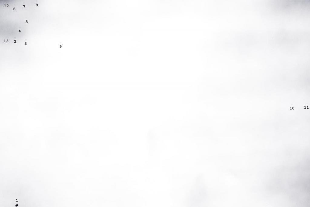

OK, I may be a little ahead of myself, but as I was processing photos taken this morning I saw these ... after already cloning out one dust spot. I haven't stuck a blower in there to see if they disappear, but given that I had no spots 10 shots before this I'm about to put my head on my pillow in a minor fit of dispair (upper left corner). I'll keep ya posted...

I'm suspecting, and hoping, that when I open the camera up and blow it out this morning before taking a walk that the spots will disappear. The camera has been through nearly 1000 actuations and at least half a dozen lens changes, so getting a little dust in there isn't unexpected. I'm just hoping that's all it is.

Alas, even after blowing the sensor "clean" this is what I have - including an extremely dark particle on the bottom left which is visible even at f7.1. I'm not even going to bother wet cleaning, I'm calling Nikon. Color me disappointed.
