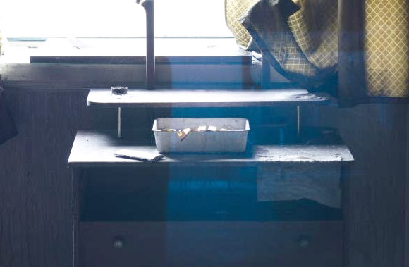

Have used Nikons for years without a single issue...loved my D70 which took flawless photogrpahs. A couple of months ago I upgraded to a D7000 and was horrified with the pictures, most which were unusable. There were major blown highlight problems to the extent the photos were useless but the biggest issue [and strangest] was the deep blue/purple colour of the highlights especially around windows with light coming through broken glass [I photograph abandoned buildings]. Additionally, in many photos I was getting duplicate light reflections which would end up looking like square blocks of blue light or huge swathes of blue light on the photogrpahs. These simply had to be deleted.
I am an experienced photographer and know my settings to a tee....Googling this issue returns no results.

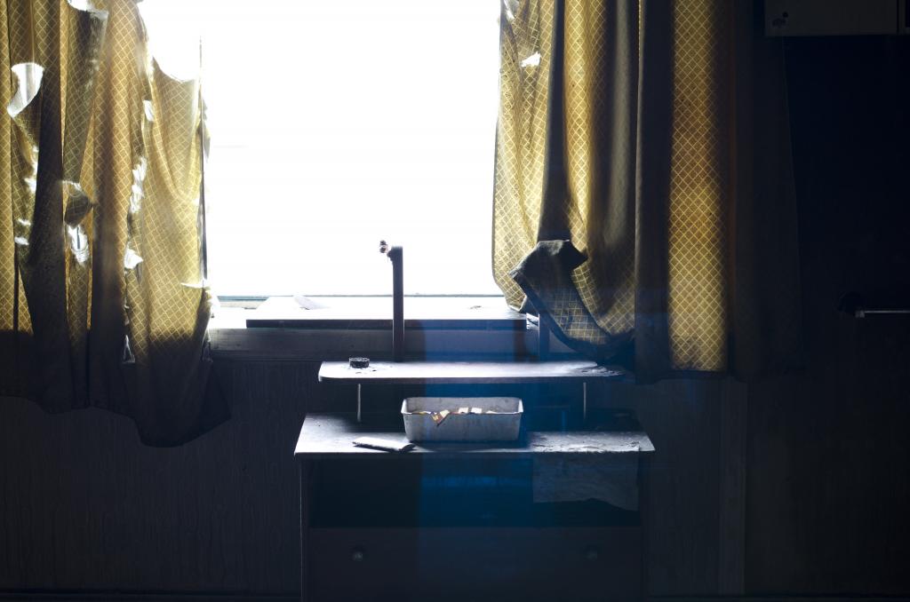

It becomes more bizarre.....I sold that camera out of frustration and bough a new one, a D7000 again. To my horror exactly the same thing occured. I have ruled out the obvious things. I changed cameras and took the same photos and with the D70 flawless pictures. I used multiple lenses so it isn't a lens issue either. How can I have 2 different D7000's throwing up the same major problem when noone else seems to have this problem???? It is bizarre.....am I jinxed? In all my years of photography I have never seen anything like this so please guys....any help. ideas. suggestions??????? i have attached a sample showing the weird block of blue light.....
james
BackdoorArts
I'm not just seeing blown highlights, I'm seeing details in there. It looks like the details that would likely be viewable outside the overlit window are reflecting off the lens and onto a UV filter and then getting picked up by the sensor. Over the front of the chest it definitely looks like there are details from somewhere else. It's not a camera issue, it's a user issue. Filters will give you all sorts of ghosting when shooting between very dark and very bright subjects. Take off the filter, try it again and see what you get.

It's difficult to say what is causing it, but it's not normal for sure. What's up with the drapes on the left? Seems to be some kind of double exposure going on there...
For the blue, it does look like a flare of some kind but I wouldn't bet on it.

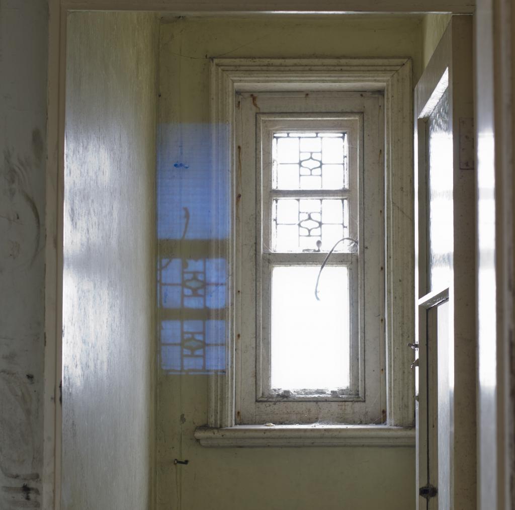

This first one shows a definite reflection in blue of a nearby window
attachment.php
This show the blue light spilling into the window - being a low qual jpeg it isn't blatantly obvious but in raw with the NEF file it is very obvious and has to be cloned out.....
attachment.php

The last one - again - is a reflection of the window but upside down! wasn't using a filter, was using a tripod.....was going slightly crazy!

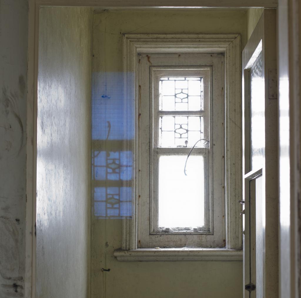

attachment.php
attachment.php
What I find real strange is that on one picture it's on the right and on the other it's on the left...

This looks like light reflecting back through your lens, hence the reason it's upside down. This will occur when you use lenses that have lost their internal blackening or have been modified, or are very old. I looked through the thread to see if you listed your lens but couldn't find it. What lens are you shooting this images with?
