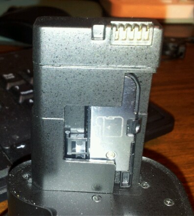

With both the Neweer and Meike units, it should have a holder for the door in the upright that fits into the battery opening. Thats where mine is stored on my D5100

Here are a couple quick photos from my cell phone...
showing my 5100 door with grip behind...
showing the door in the slot in the grip made to hold it...
This has worked well in my D5100...
