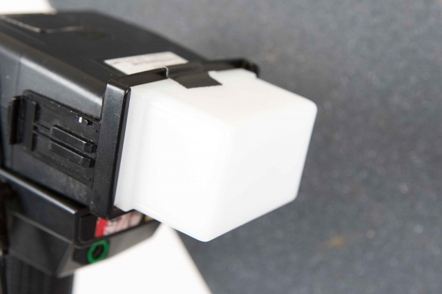

I have a rectangular one (box shaped actually) which slides into the notches around the front of my Sunpak 544's, similar to the Amazon one in the photo below, and it allows me to fill the frame evenly with light down to a 20mm lens on FX. It actually almost covers a full frame 16mm fisheye lens! You lose roughly a stop using it, but it also softens the light considerably too. If you can find one for your popup flash then by all means it would be a worthwhile investment. But as has already been said, pop up flash are very anemic when it comes to power, a separate flash is a much better bet.

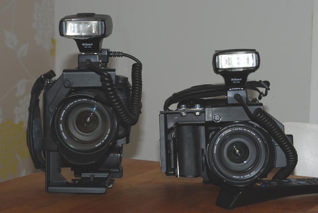

personally I have given them up as they reduce the light output too much and dont solve the side shadow if you turn the camera into portrait. The only thing that does is this flash flipper ....dont use a fash without one ...$20

If you look at the photos you will see that the flash is always over the lens in both portrait and landscape ...does you bracket do the same ?? I oould not want people to think it did if it did not ..Having the flash as close to the lens is also vital to reduce shadows on walls behind...I the work I do it is not possible to lift the flash high enough to throw the shadow out of the picture ..3-4 ft

That contradicts everything I've heard or read about moving the flash away from or off the same axis as the body/lens to help avoid things like unwanted shadows/red-eye etc??
If you are in a non studio situation you can only minimise shadows on walls behind people ( say guest making speaches at a wedding) and to do this you need the flash over the lens and as close to the lens as possible .....That flip bracket is the best kept wedding photographers secret ever....
But I give it you for free ....!!!
