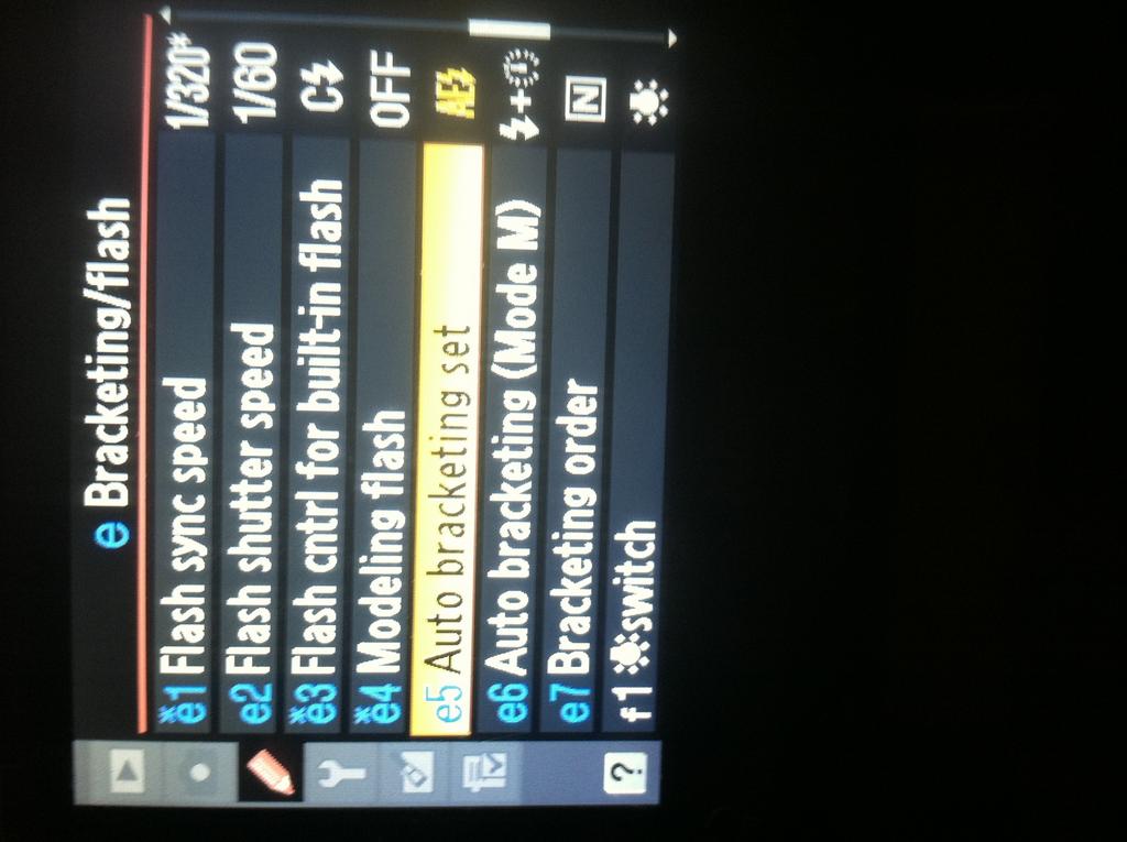

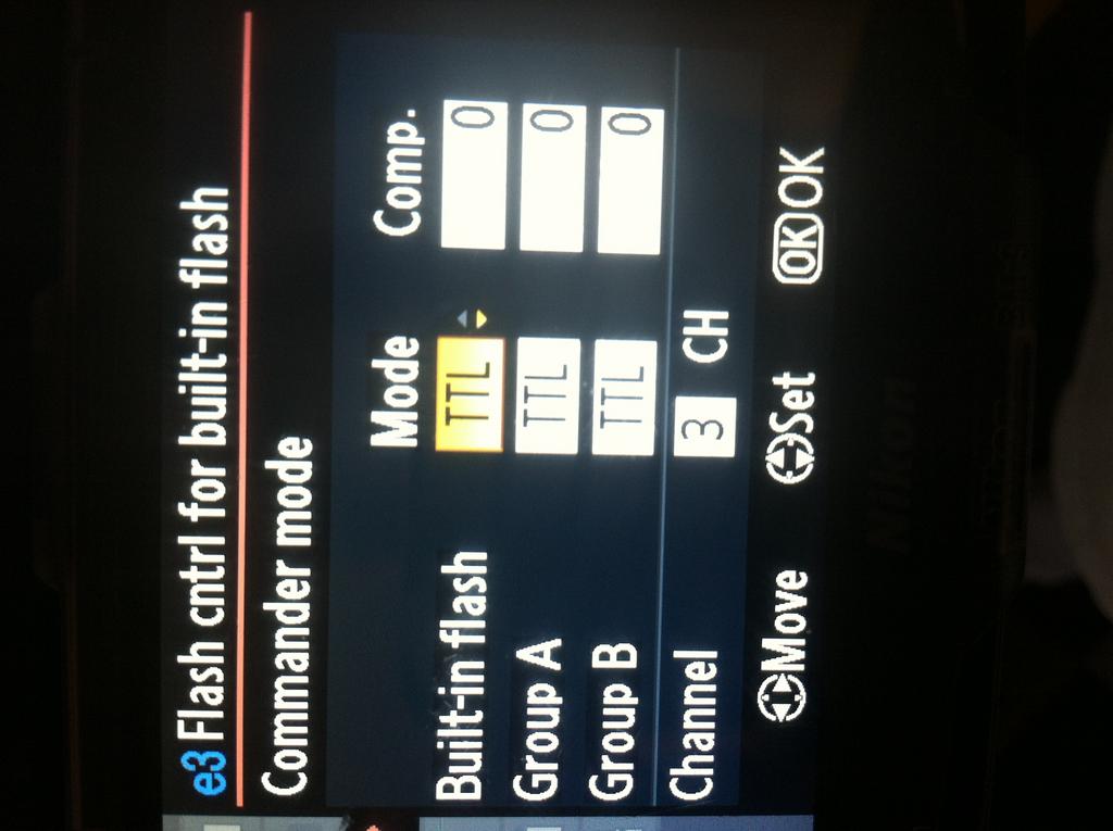

I am adding pictures below of the current settings on the camera. Any help is greatly appreciated!

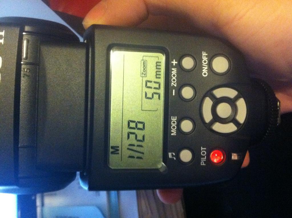

The modes are about the only thing that could affect this, right? The modes are: M (master), S1 (slave), S2 (slave for pre-flash), and Multi.
There really isn't much to look at, but here it is:

The 1st thing is.. Modes.. M is for Manual, NOT master.. It is NOT a TTL flash, it is a manual only flash.
What Mode are you using???
On my 5100, it fires from the Hotshoe but in manual mode only and does NOT work with the camera in Auto... I have to manually set the camera, thats why I have a SB-700 for On camera and only use the 560 Off camera.

I stand corrected, the reason I called it "Master" was because I watched a video on Youtube that referred to the mode as such. When you say "What mode are you using," are you asking for the mode of the flash in the camera (I posted a picture in an above post with the current settings) or are you referring to my shooting mode (aperture priority, shutter priority, auto, manual)?

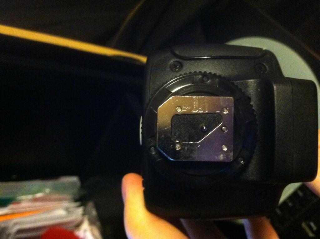

How many connector pins are under your Flash? Have you tried to just short them to see if the flash would fire?

I am attaching a photo of the mount on the flash. I have not tried to short the flash, I am not even sure how to do that with a flash. It does fire when I push the "pilot" button, and it works OFF the camera when I use slave mode and fire it with my built-in camera flash. So, the flash does work just not when it is in the hot shoe. I mainly use flashes off camera, it is just annoying to me that it isn't working as it should be.

Just try to touch the 2 protruding pins with a metal object (pin or knife) and see if it flashes. When you look at your camera's hot shoe, do the pins seem to be at the right place compared to the ones on the flash?
logan
Ok, I just tried that and it did fire. And, the pins are in the right positions (one is about an 1/8" from the front of the mount, the other about 1/2"). Maybe it is a hot shoe problem...

What Mode is the Flash in??? When you mentyion Slave Mode for Off Camera, I assume you mean S1 (or S2)
What Mode when in the Hotshoe?? It needs to be in M when in the Hotshoe...

This just hit me drop the shutter speed below 1/250 and see if that works also before tightening see if there is wiggle do one way tighten see if it fires loosen but wiggle the other way. Just in case it does not line up. Just a shot on the dark. No pun intended.
