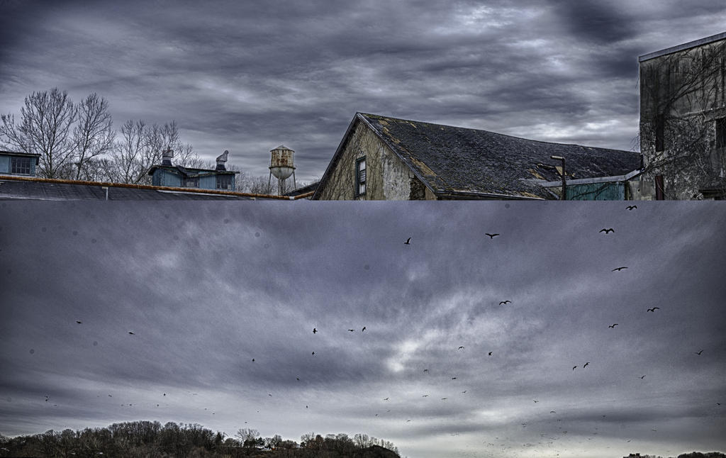

I do have to say that as I processed my shots from yesterday I did get more than a little disgusted with the dust thing. I blew off the sensor prior to going out yesterday. Put my new 16-35mm on and did not take it off all day.
Here's the top portion of a pair of shots taken yesterday, HDR post processed (no cropping), stacked one on top of the other. The top photo is comprised of the 2nd thru 4th shots of the day, the bottom come about 300 actuations later. As we know, HDR does a great job of exposing these spots when they are there. Just look at the difference!! I want to say I had to spot heal at least 2 dozen, if not more (tough to tell with the birds). It's almost ridiculous. As I've mentioned before, this seems to worsen more quickly when I shoot in Ch mode, which I do for handheld HDR (3 bracket burst), and 3/4 of what I shot yesterday was done that way.

D600 Before & After Dust Spots
BackdoorArts
Ooops - miscounted. I just touched up a non-bird invaded shot done 12 frames before the lower one and healed 47 different dust spots. Nice.

HDR will show you things that are not visible when shooting normally. And the wider the angle, the more you'll see these dust things. I still remember my shock when I first saw one of these on my D700, it was with the 16-35 @f16 and the camera was about 3 weeks old...

I'm very comfortable cleaning it myself - if I wasn't I would have punted ages ago, but the images are worth the effort. It's just that I have to do it far more often than I would have ever thought necessary. I dealt with dust on the D7000, but I could go a week without having to think about it. This is one afternoon's build up on a clean sensor!! Perhaps the cold, dry day exacerbated the issue, as well as shooting directly up under some tracks?
Still, given that they've acknowledged it, I may just pack up the body and send it off for a good once over. If there are other factors that contribute to the issue that they are acknowledging internally but not speaking about publicly then why not have them do whatever fixing is necessary - even if it's just a thorough cleaning?
