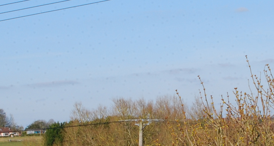

Hi,
Has anyone experienced this problem with their D40x of faint spots on a bright background?
I have used 'lock up' to clean the sensor, I have also cleaned the mirror and top prism and changed lens' and still I get these faint spots:confused:

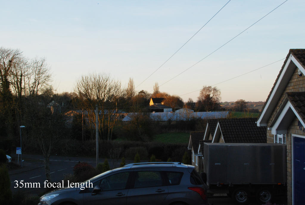

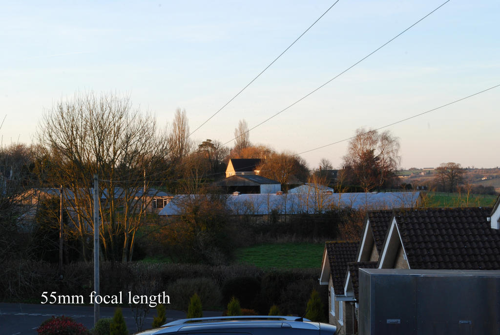

stvn
Yes, the spots do line up. I have just used a prime 35mm lens and with the same settings used a 18-55mm lens with both set up on a tripod.
I have cleaned 3 x places thoroughly so far in the camera:-
1) The Mirror
2) The Prism
3) The Sensor
