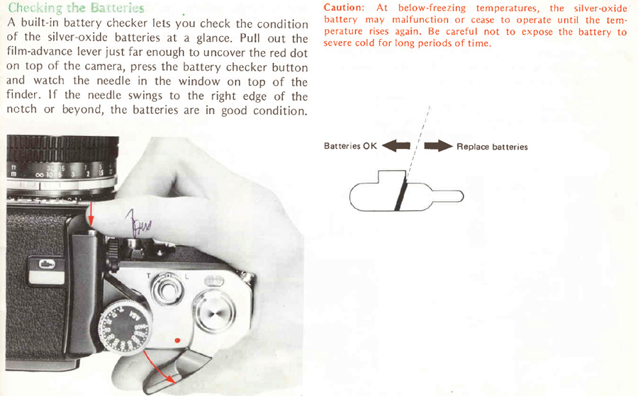

Hi, I am trying to determine if the batteries are okay on this F2 but the instructions are confusing me.
it states 'If the needle swings to the right edge of the notch or beyond, the batteries are in good condition'.
However the diagram on the right appears to say that on the left the batteries are ok and on the right the batteries need changing.
  • I have turned the lever to reveal the red dot.
  • The marker now sits on the far right of the dial.
  • When I press in the battery checker the marker sits on the right of the centered box.

I believe it's written to give the impression that the needle starts on the extreme right, and as long as it swings enough left to contact the right edge of the notch, you're good.
If the needle is touching the 'conn tower' (it looks like a submarine), then you're good.

The reason I ask is because the 'sub' image is intermittant and I do not know if:-
  • The meter is faulty?
  • This is normal?
  • The batteries are low?

One sure way to find out is to check it with either an actual picture or a DSLR. For the same iso (asa in case of the F2), you should get the same reading in the same conditions. Set the lenses to f8, iso 200, see what the shutter speed should be for the F2, set the shutter speed on the DSLR at the same speed, take picture and view the Histogram. It should tell you a lot.
If you are going to use this approach, the scene you need to use with both has to be homogeneous in exposure value, like a cloudless sky or sidewalk, etc. Because unless the digital camera is set to centerweighted mode (I can't think of any of them but my knowlede of digital cameras is not very extensive) it may meter the scene very differently than the 60% centerweighted metering of the F2. Ideally you should use a 18% gray card, something I think all photographers should have in the their camera bag, and fill the frame with it with both cameras. And keep in mind that not all cameras will meter exactly the same, CdS (which I am sure is no longer used but the F2 Photomic used them) cells see things a little differently (sensitivities) than Selenium. I honestly don't know what cameras use now. If the two are within 1/2 or 3/4 stop of each other, that is usually ok.
