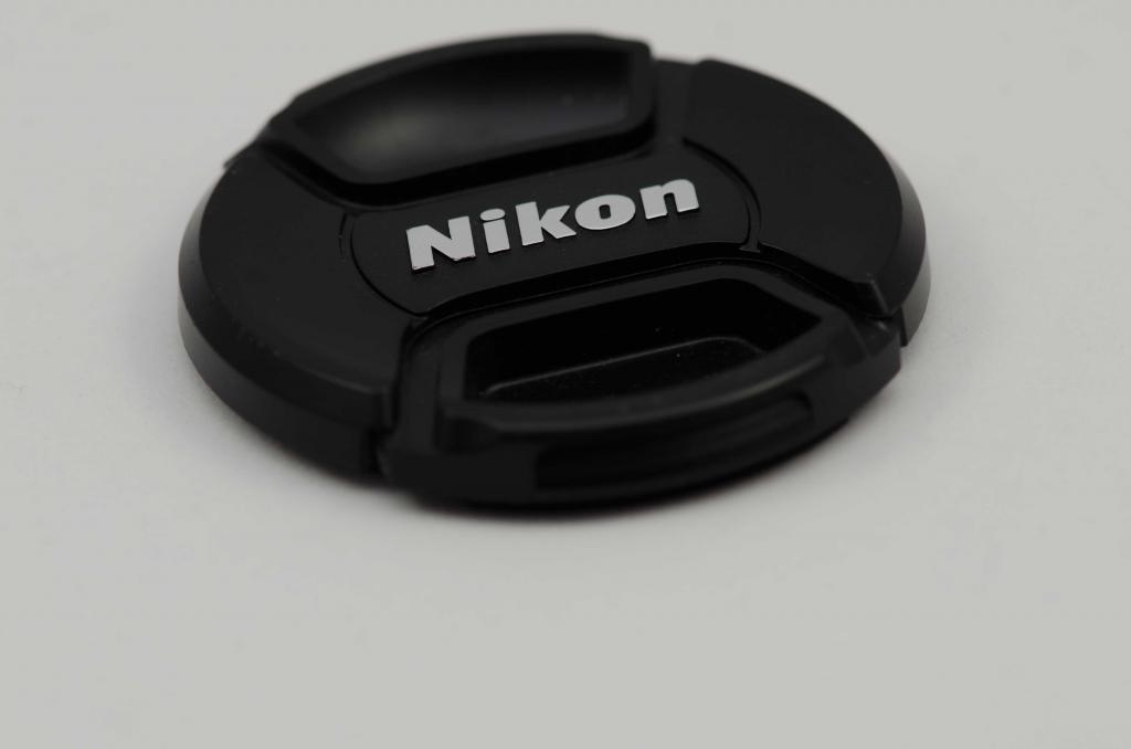

unkyjohn
Hi All
These long summer nights have been keeping me from my laptop - here is my first attempt at preset wb as described in the manual
What do you think?
