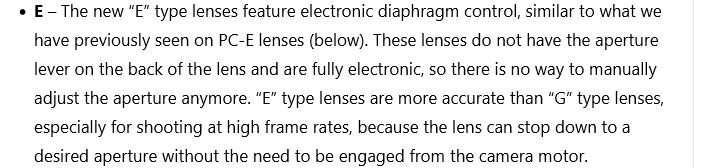

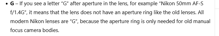

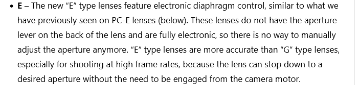

So, with E standing for electromagnetic aperture, does G stand for mechanical aperture or something else?

nikonbill
Yoram,
A quick web search turns up the following on Nikon lens:
Research the build -- weight can be several things such as but not limited too, more "glass elements", larger physical size......
