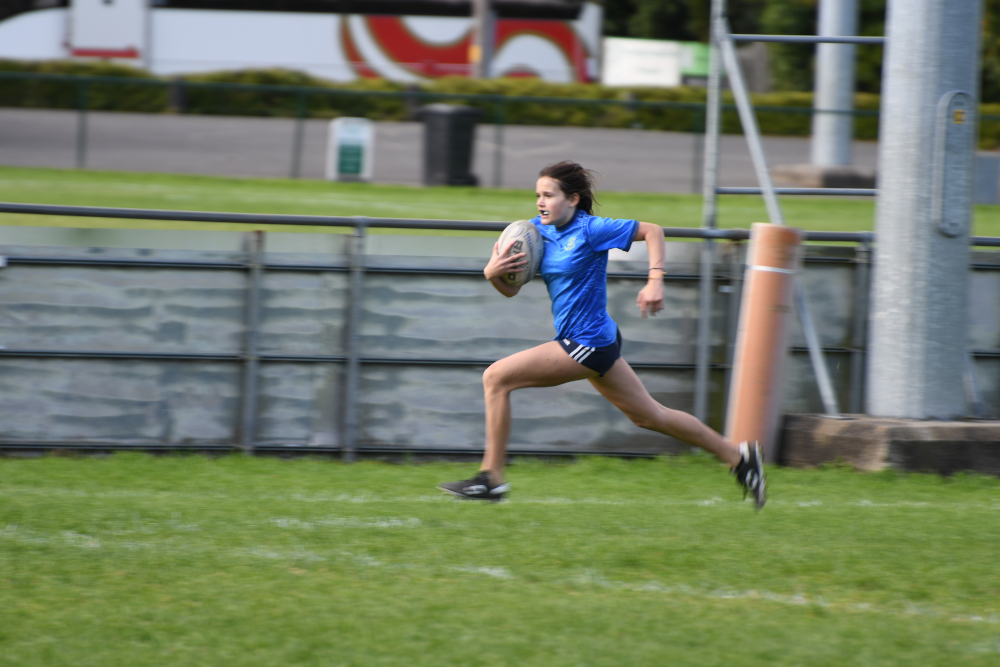

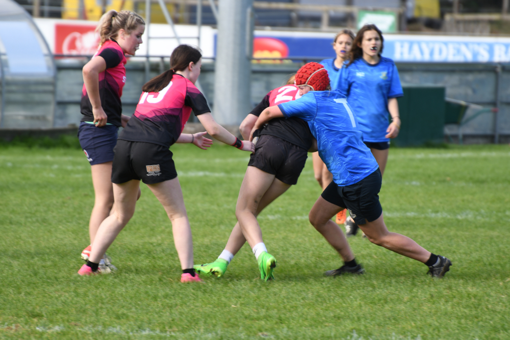

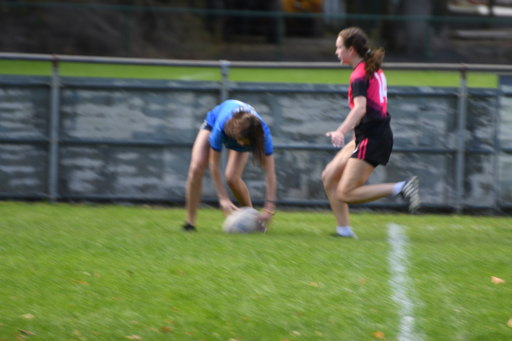

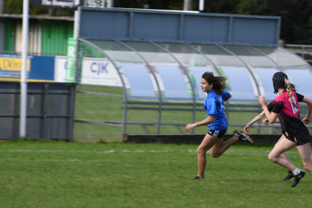

Here are some images I took, along with my thoughts. Obviously some of these may be down to technique rather than hardware, but all feedback greatly appreciated. I'm trying to move from a spray and prey technique!
First off, one I'd consider good/acceptable:
Now on this one - I haven't got the lighting right - too much brightness / shadow. Not sure if my technique, but I have a nagging feeling the auto mode on the d5000 would have resulted in a better pic (and I'm not sure what to tweak on the d500 to compensate):
The next two were taken in sequence. First one in focus, and the next one (which could have been a great pic) just a little out of focus:
And finally a random out of focus shot. Not sure why, but I had a lot of these:
All of these were taken on P shooting mode, Qc release, AF-C Grp focus mode - with a Nikon AF-S Nikkor 70-300mm f/4.5-5.6 G IF-ED VR lens

Here are my observations and worth every penny you payed for them. :)
2nd photo mainly harsh lighting (midday shot)
The last three use a higher shutter speed. 250? Once you get familiar with how the camera handles you may be able to go down. I went from a d5100 to a d7100 I found I need a faster shutter speed. Practice panning with this camera and don't be tempted to use the other one until you have a good handle on this one. Turn on your focus point in the play back mode so you can see where it was or even if it focused.
I'm sure other will have better insight.

All three posted pictures show an ISO of 100. A lot of folks think that you have to shoot the lowest ISO to get good pictures. While low ISOs are great, a sharp image with a higher ISO is much better than a low ISO, but fuzzy shot. As was suggested before, shooting in manual mode with auto ISO is what I use and , IMO, works well for action shots. Just keep an eye on your ISO and don't let it get too high. Experiment with what shutter speed is needed, I would probably start at 1/500. You might be fine with a little lower, or a little higher. It will be more about percentages of sharp shots, not a line in the sand. Remember, a noisy image can be fairly easily cleaned up in post processing. If you shoot a lot of high ISO images, you might consider investing in something like Topaz software to clean them up. It can do wonders with even very noisy images.

Here is my feedback for sports with the D500, hope it's helpful:
You need a faster shutter speed. The blurring in these shots is almost entirely motion blur. Get out of P mode and use shutter priority, or take the next step forward and learn to go in manual mode. Try to pan with the subject as best you can to further reduce motion blur. For something like rugby, I would use 1/1000 or faster. In good light there is no reason not to go up to 1/2000 or faster.

You have motion blurring going on. For the sports action, it is crucial to take control of shutter speed and not let the camera guess your setting. It is a good time to use the Shutter Priority mode if you are not comfortable with taking the test shots and estimating the f-stop in Manual mode. I would set the ISO at 100-Auto so it will automatically increase ISO as required. 1/1000 is a reasonable speed in my mind also. I believe you will find the camera in S-mode at that speed is going to select the widest aperture of the lens anyhow and the ISO will be what changes mostly.
Panning with your subject is a skill that takes practice. Just keep trying. This will still blur the surrounding stuff but help the subject to be sharper.
The 2nd photo as was noted that is around midday in bright sun. That means lots of contrast to the shadow. If you shoot with RAW format and post-process, there is a bit of room to lighten those shadows. Otherwise the only option to fix that is to be close and use a fill-flash or have an assistant hold a reflector shining on the girl's face.
