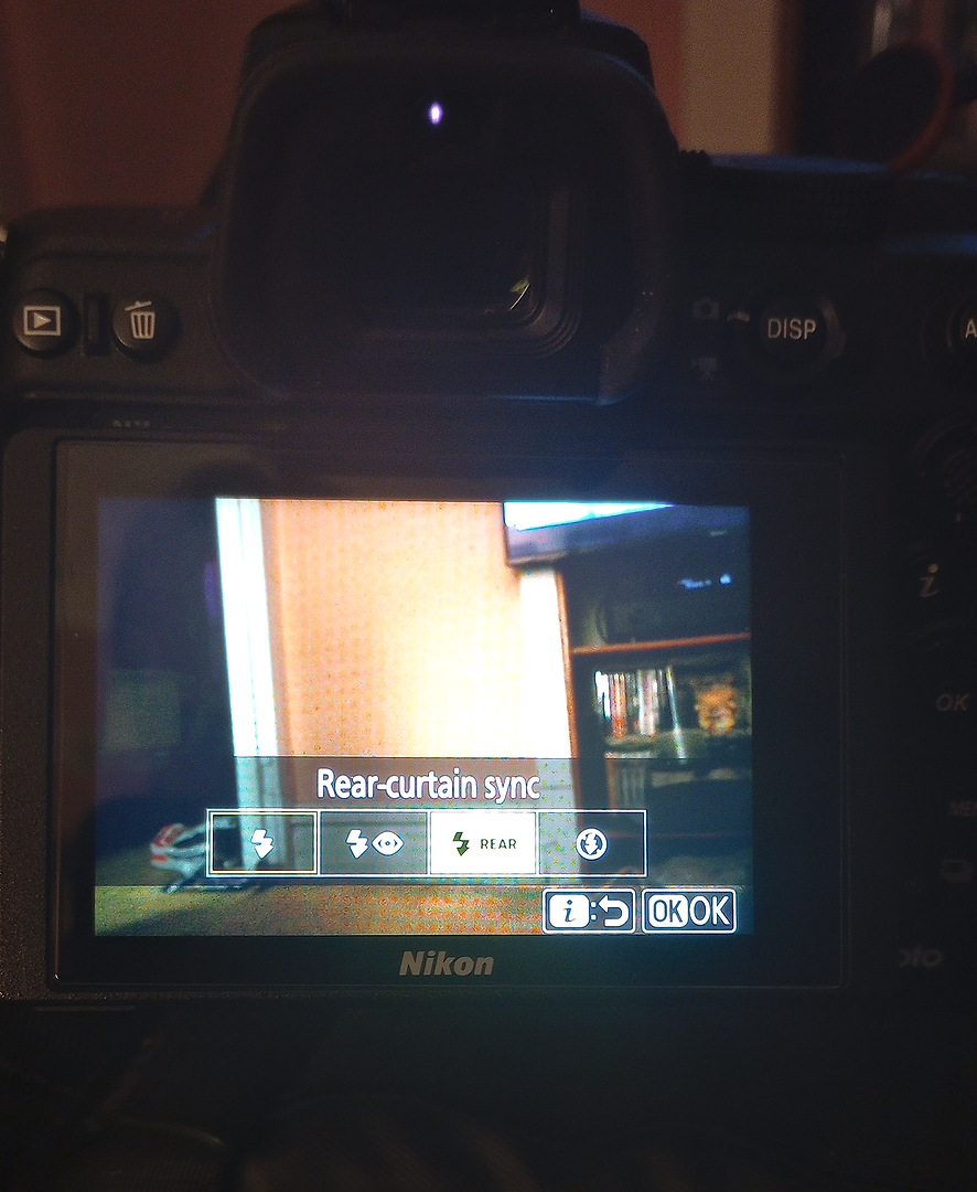

BF Hammer
Since I needed a flash on my Z5 tonight... Rear Curtain Sync on the I-menu with my SB-600.
