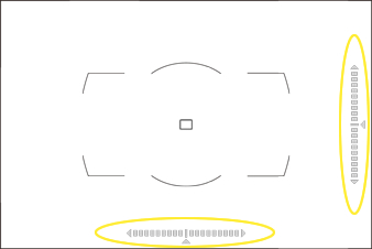

So you've gone into the Custom Settings menu, f3 option (Assign Fn Button) and selected "Viewfinder virtual horizon", yes? Because that's really all that's required. Now when you press the Fn button you should see guides at the bottom and right edges of the frame when looking through the viewfinder:
I've known a couple people who were expecting to see this VH in the viewfinder:

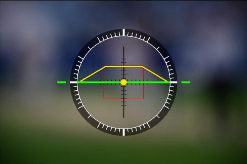

But this Virtual Horizon only displays in LiveView (it might look slightly different on your D7000):
