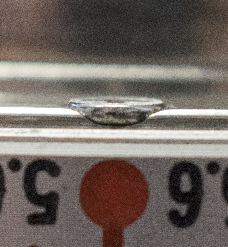

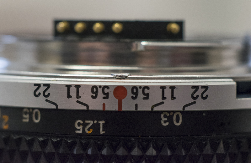

If you look at Nikkor Lenses, the lens mount screws on the lens are flat-head and inset. On the Olympus 28mm f/2.8, the screws are pan-head and recessed for a fit to an Olympus body.
If you're using the original screws, you'll need to file them down to be flush on the "special" Olympus mount. If you don't, the screws will not only scratch the ever-living bejesus out of the mounting ring on the body, but it will not turn more than about 1/4".
Pictured: Unfiled screw. They don't stick up much, but it doesn't take much to impede coupling.
I used a Tamiya #400 diamond file, used to file down metal 'detail parts' when cut from a metal sprue. At the time of this writing, they're about $10.
Once the screws were flush with the mount, the lens mounts just fine and there are no issues with coupling or decoupling.
