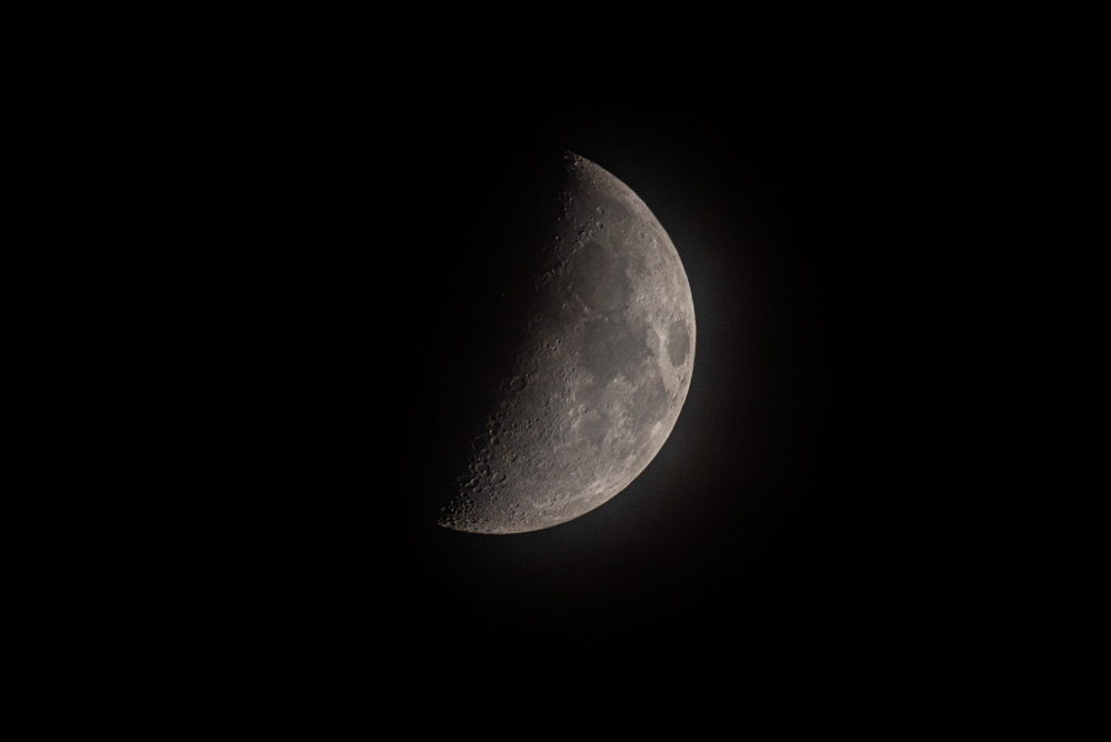

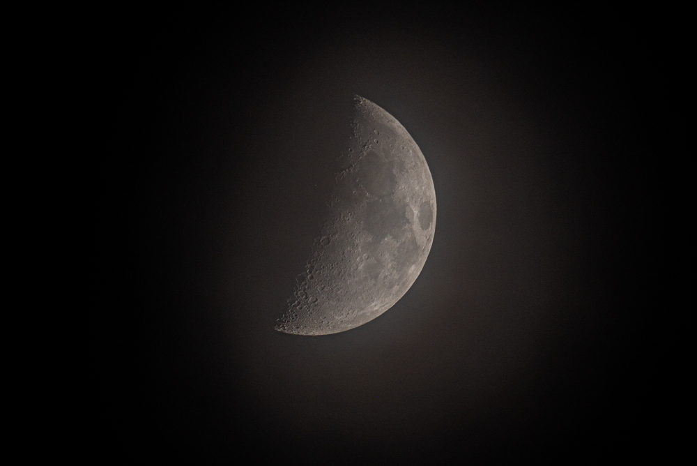

I shot this picture of the moon last night. There was a thin layer of clouds and I live in a decent sized suburban area, so lots of light pollution. Here are two iterations of the same image the first with dehaze cranked down, and the second with it cranked up, although only about a quarter of the way towards max. Not sure if the cloud cover will react similarly to light pollution, but I would think it would.

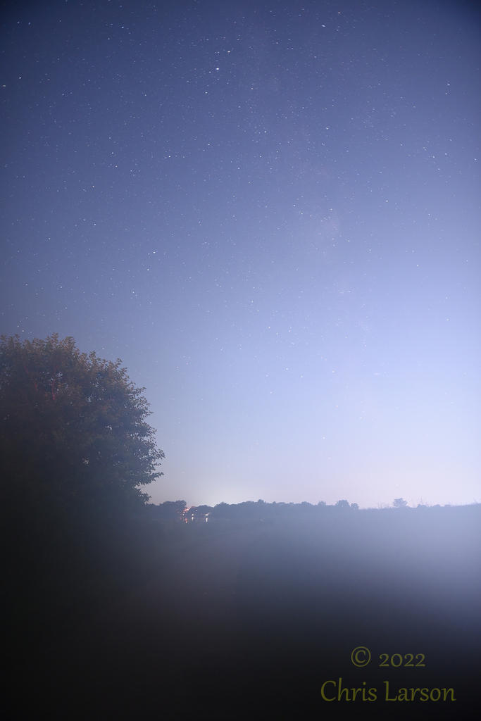

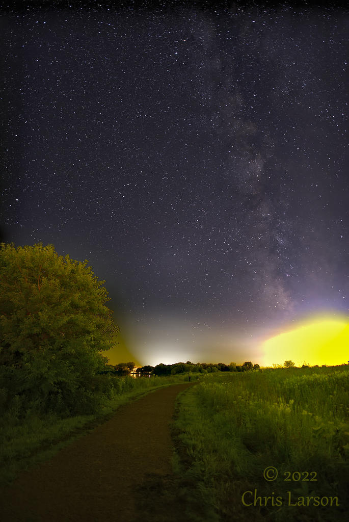

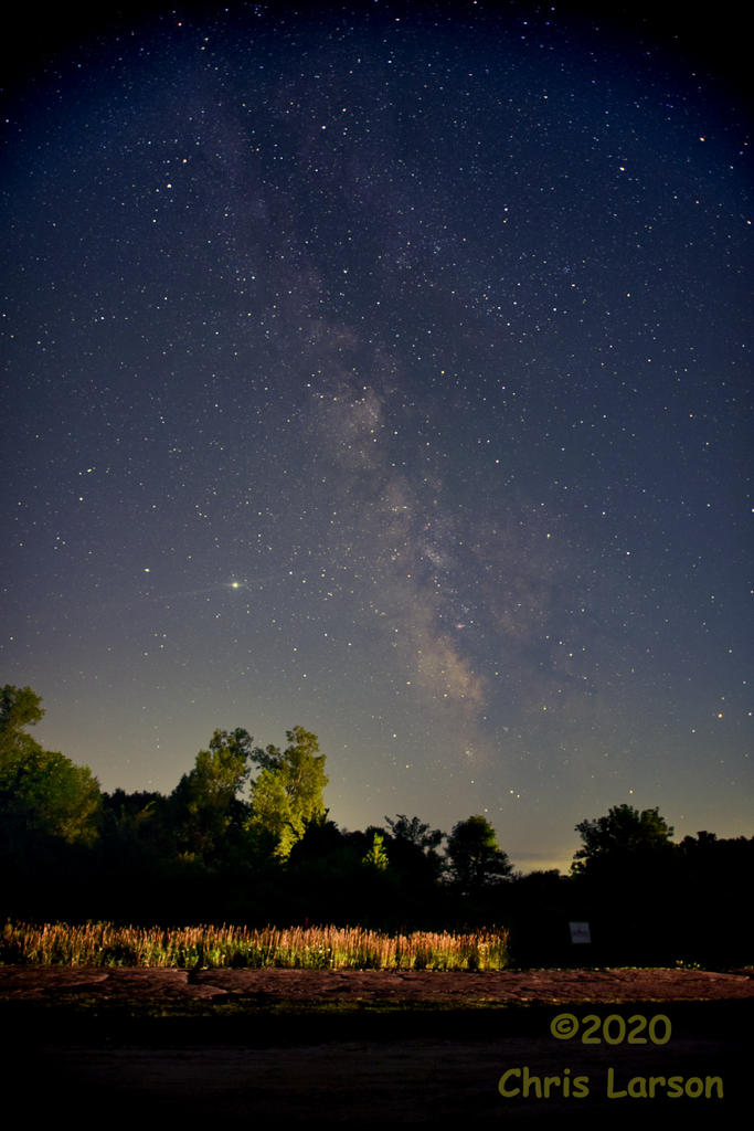

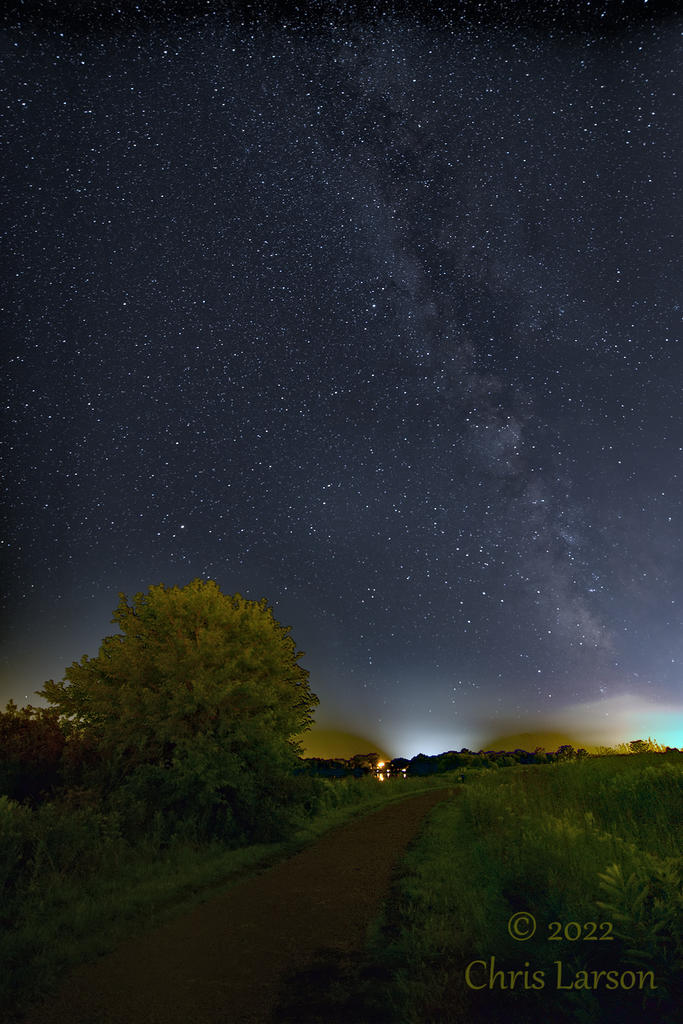

Here is a night where I used the light pollution filter. This is aimed more or less in the direction of civilization, but it is the darkest sky location that I can drive to in 25 minutes. First shot is a single outtake of a series of photos where the trees are painted by headlights of a car. Second photo is an exposure stack of about 30 shots.
Sequitor, which is what I stacked the exposures with has it's own light pollution filtering in the options so that is why the horizon gets so glowy in the stacked image. But this run was cut short due to fogging of the filter half-way through the 60 images the intervalometer was programmed for.

The moon is far too bright for any need of light pollution filters. As a matter of fact a full moon often is light pollution itself as it will obscure many nighttime objects that are visible when there is no moon in the sky.

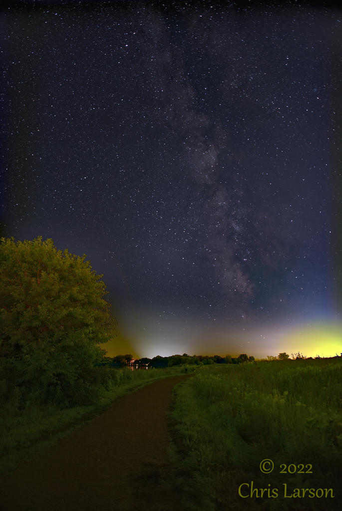

I took out 2 cameras last night to a spot on the edge of my hometown. I shot into a light polluted area. The Milky Way was positioned south where there was a neighborhood on the other side of some higher ground. With my D750 + Sigma 20mm f/1.4 I started a series of 99 photos with my light pollution filter in place.

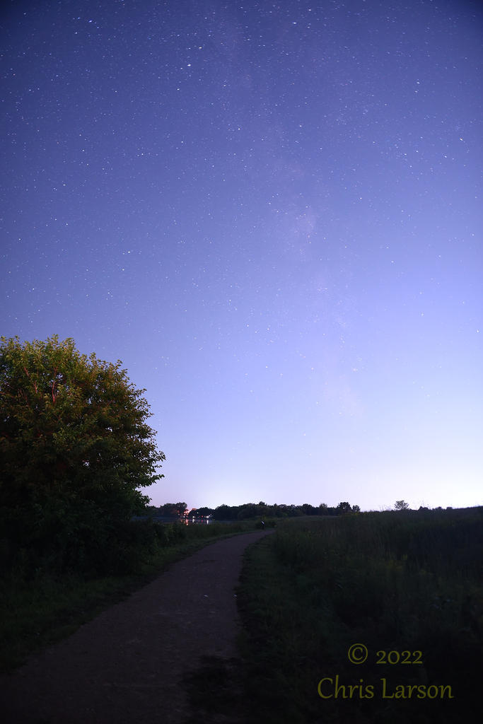

Since it is night and we are approaching dewpoint, this filter fogs up quickly. I had to remove the filter about half-way through the series. This is a no-filter image.

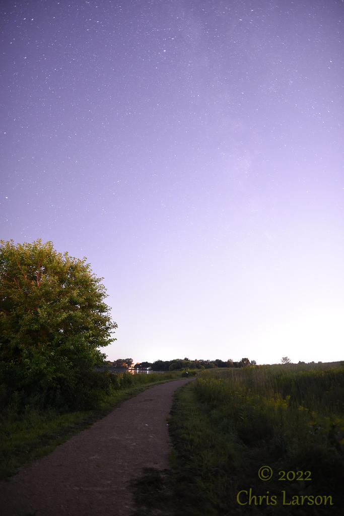

Fogged image sample. These first 3 photos are jpegs straight from my D750.

I never changed the exposure settings during the run, but should have turned down the ISO after removing the filter. But this illustrates the biggest issue with using these filters I have. My big 150mm square filter fogs up every time I use it. I have a dew heater for the lens, but it does not warm the filter holder well. But the filter does make a small difference when it works. And you might notice the stacked sky color is close to the same in each but different straight out of the camera. That is because there is a light pollution reduction setting in my image stacking software that does a fair job of fixing that. But the blob of light pollution at the horizon sticks out in the non-filter photos.

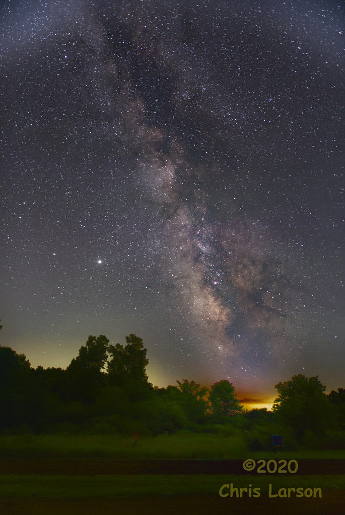

And bonus image, stacked set of 88 images from my Z5 + Zeiss 15mm f/2.8. No filter (mount does not fit). However I forgot I had been using a film-simulation profile instead of standard color in the camera. Think I lost color due to that. Light pollution definitely better due to lower exposure setting (shot at f/2.8 instead of f/1.4) and also by using over twice the images to stack.
