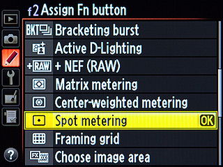

With the smaller thumbnails if you press the minus magnify button #40 Capture.PNG it will show more thumbnails. I am unsure if this can be done via the AF area selector. Maybe see what options are available to be assigned to this.
rocketman122
Yep there's the thumbnails! bravo buddy!
