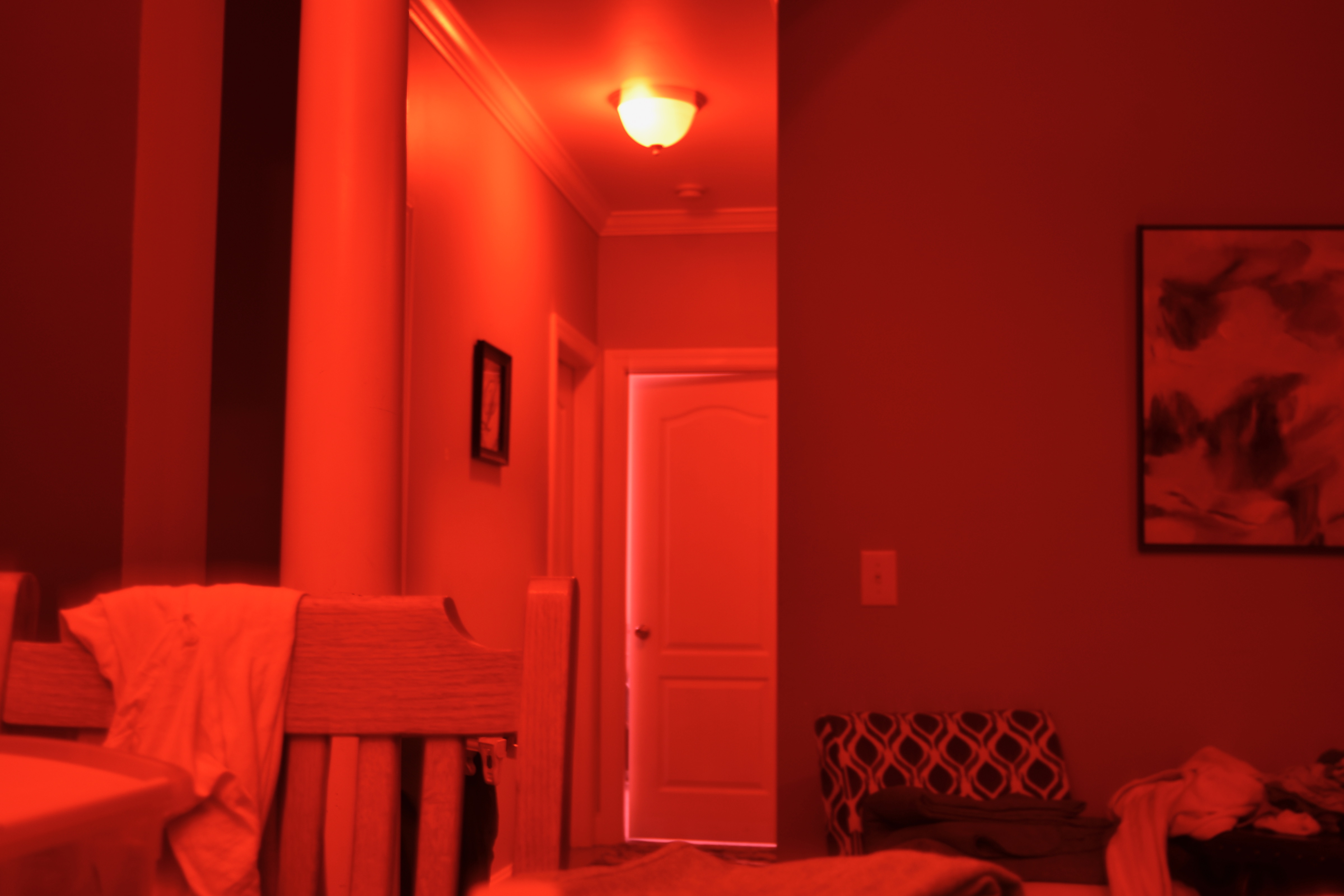

I recently bought a Nikon D810 through an auction house. I spent the same amount on it that I would have spent to get a used one. I am not a professional photographer, I just wanted a camera that could do more... hopeful that I would learn how to use it. It is ONLY taking pictures with a red/pink filtered look. (see link).
I reset the settings a few times…I tried setting the white balance to auto and then modifying the auto to green and the pictures didn’t look any different….also tried resetting the white balance with a white piece of paper. I don't know what to do. There is not a repair shop anywhere nearby and I'm leaving for a cross-country trip in a week. PLEASE any help would be appreciated.
This is what all my pictures look like.. it looks like there is a filter on it. I looked at the shutter count and its only 4,000 so it doesn't look like its been used a lot but I don't know enough to know what to do to change it to a normal coloring.

Take it outside and photograph something with green leaves or some kind of evergreen tree or shrub. That will be what tells me if the visible-spectrum filter on the camera sensor was removed and either replaced with an infrared-pass sensor or a clear sensor for full-spectrum. People pay $300+ to have a camera altered in this way.
Full spectrum is commonly used for astrophotography so that more light from outside of visible range can expose the sensor. Infrared conversion replicates using infrared film with a special infrared filteAr. It gives a specific look and can often see through haze better to reveal details.
Hold on, my memory is being tickled. Nikon did their own full-spectrum conversion of the D810 and marketed it as the D810A (for Astrophotography). Is the badge on the front of the camera actually a D810A? See link.
BF Hammer
I did a bit of WB adjustment. I cannot do an extreme adjustment on a JPG like I can on a Raw image. But I substituted in the WB color temperature from one of my infrared photos on to your's. This has me thinking more that it is an IR conversion. Short answer, it is not worth trying to convert the camera back if it is an infrared conversion. Better to trade in for another straight D810. Or even better if you can handle the upgrade for a used D850.

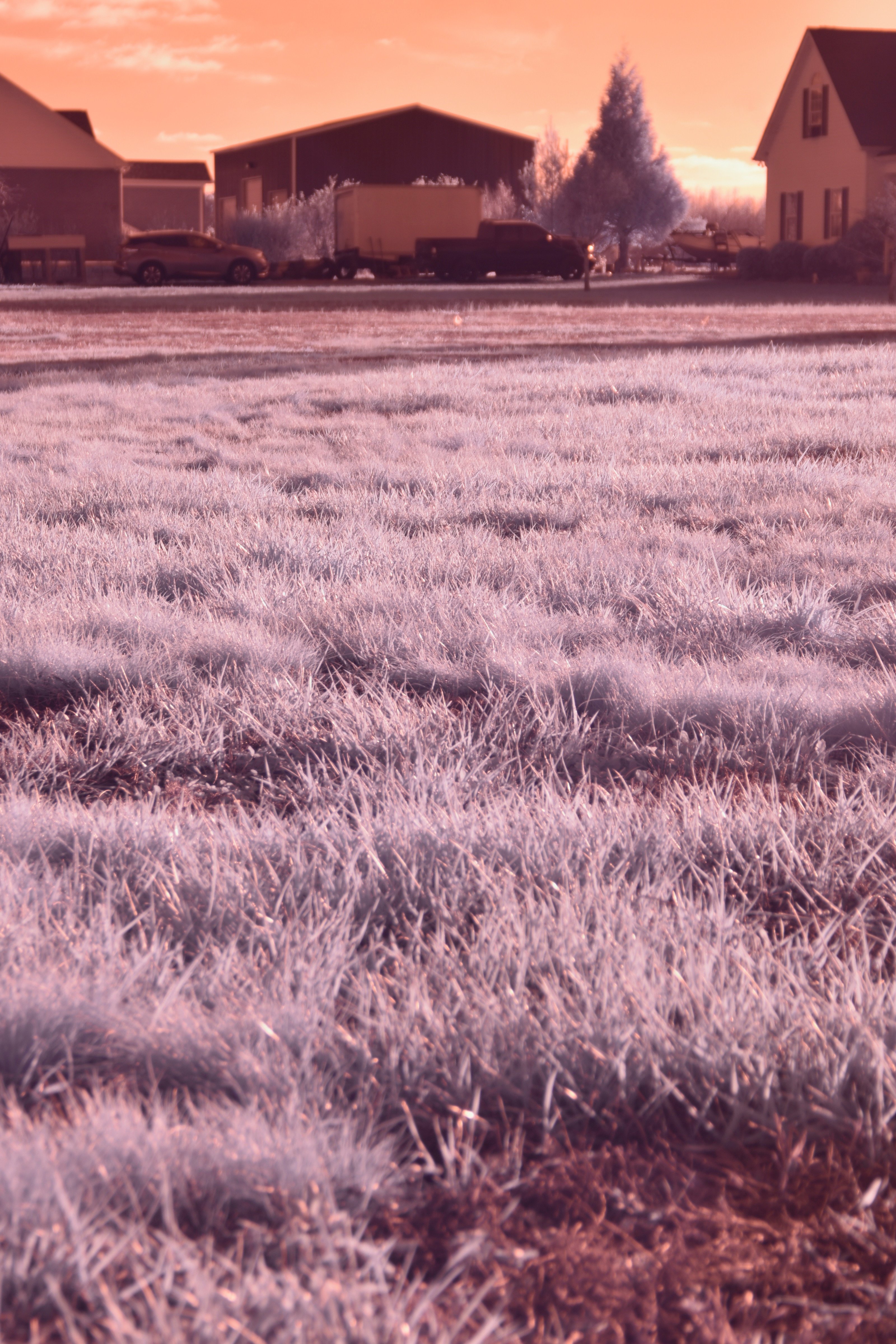

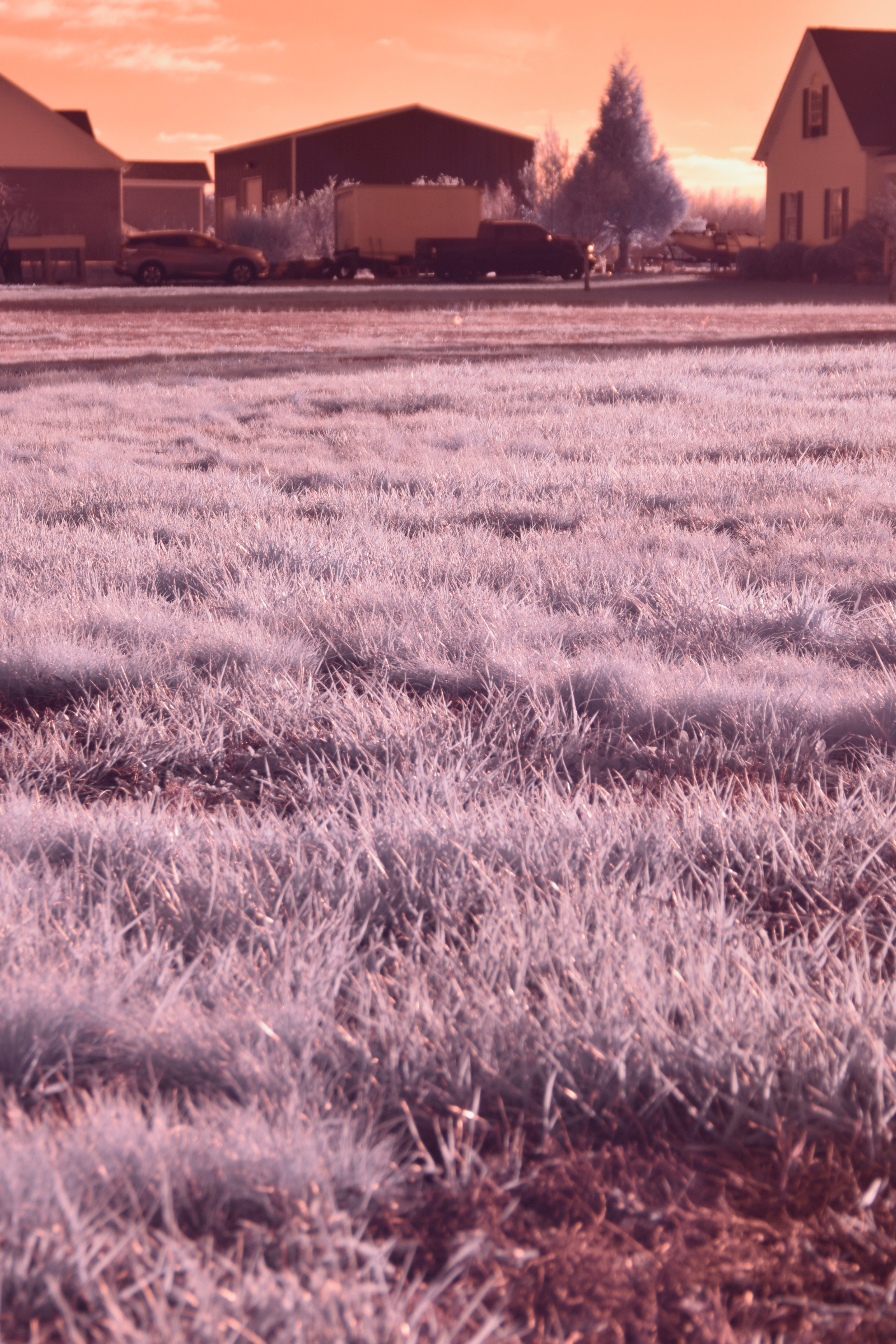

Here is a picture from the camera from today. Its sunny outside and this is my front lawn, very green still here in middle Tennessee. What is your thoughts, @BF Hammer ?

Oh yeah, it's an infrared conversion. Looks like a 720nm IR filter used.
So selling to an individual is really going to be a right person, right time sort of thing. May take months as this sort of photography is done more in the summer. Your quickest option to sell the camera is to use a reseller like MPB or KEH and take the loss. Maybe consider taking the credit and buying a lesser camera body instead, like a D750?
