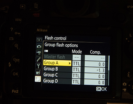

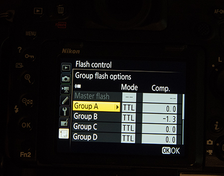

Dunno, that's what I'm trying to find out:confused: I guess I'm just curious really.
no pro
In my manual, page 199, it says only sb-5000, 500,400 or 300 will turn it on. Those models need it, except for the 5000, and it can display on the flash or the camera. My sb700 and sb910 will not turn it on.
