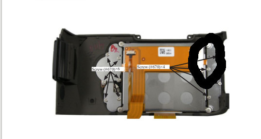

I am not a camera tech but after looking at a D-90service manual it appears they are using a button scheme similar to a silent keyboard. When you press the button a conductive rubberized material (#421) contacts the rear FPC unit. I have had mixed result cleaning the rubberized material and contacts, for key boards.
Look for break in the ribbon cable here.

Thanks for the reply. I will give that a shot and see what happens. I removed the metal support and inspected the ribbon cable and the back of the button itself and they appeared to be in good condition. I will ohm the button and the flex cable to eliminate them.
Greg3000
After further testing, I discovered that two of the ribbon cable contacts that plug into the main board were broken. I'll have to order another FPC cable. When it arrives I'll install it and post whether it fixed the problem or not.
