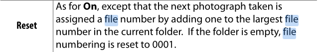

I don't have an 850. From the 810 manual d6 file number sequence
From this it would appear Rest is indeed what you need to do. Just make sure that the folder contains the last image taken. You should verify this is the same with the 850. After, it would need to be change back to On. Is there any posibility that this setting is set to Reset this would explain why it picked up the last file number. As I never tried this, proceed at your own risk.

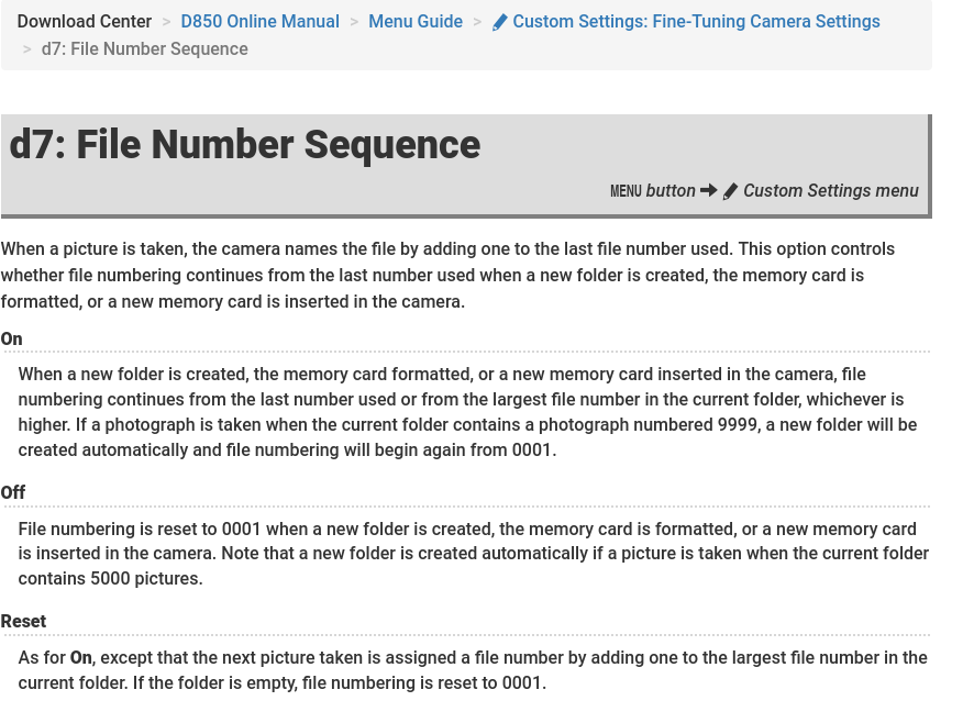

From the d850 manual:
Looks like they changed the location.

I will have to check on this a little more then. I don't have an on or off option or even the reset as its stating and I have searched everywhere. I did notice this line here, "On When a new folder is created, the memory card formatted, or a new memory card inserted in the camera, file numbering continues from the last number used or from the largest file number in the current folder, whichever is higher. " This may be part of the issue since the file that's currently being used as the sequence is higher than the one I am trying to get back to. The SD card was not formatted or new, it was the current SD card for my camera, but the last number used was the one I downloaded. I am thinking if I use another card or format then it would go to 0001. Actually, now that I think about it, maybe I do that so now the number is 0001 and lower than what I want it to be. I can just put the last picture file back in the folder and it may start the next picture from that one.
