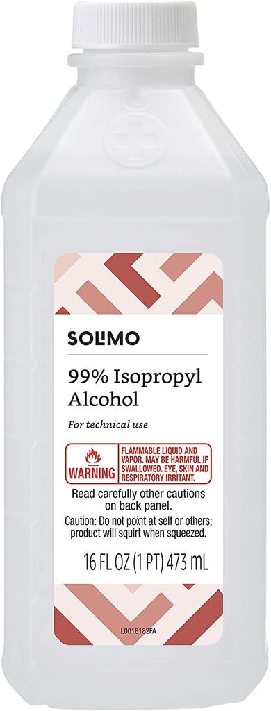

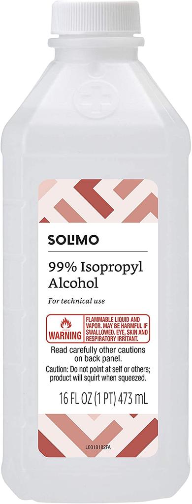

If you aren't using lenses with aperture rings, then consider cleaning the contacts inside the body cavity. I had that issue with my 300mm f/4 PF. In addition to cleaning the contacts on the lens, I also VERY CAREFULLY cleaned the contacts inside the body with this technical use alcohol. It is NOT designed for sanitizing - just cleaning so it works better than traditional rubbing alcohol. I was able to remove more black stuff from my contacts with the technical use alcohol that didn't come off with rubbing alcohol.
Be sure to use a lint free cloth. I used one that I purchased as a packaged set via Amazon for cleaning eyeglasses.
https://www.amazon.com/Amazon-Brand-Isopropyl-Antiseptic-Technical/dp/B07NFSFBXQ
