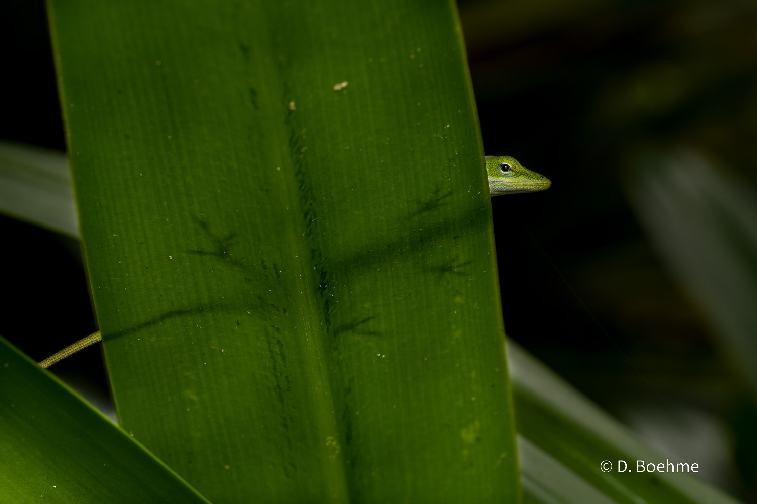

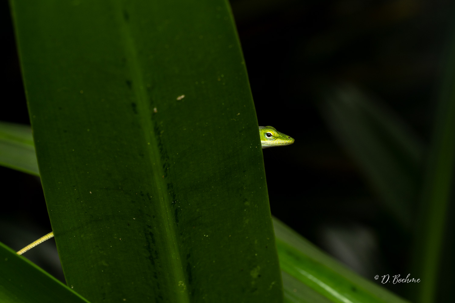

Here is an example of the effect that BF talked about.
This scene was backlit with reflected light. It was in shade, but light was reflecting off the water that was behind the plant. I wanted to get the shadow of the lizard to show, shining through the leaf. Both were shot with my 685 on, and in manual mode.
Here is the first shot. There is enough ambient backlight to see the shadow, but it's not very noticeable. I had the shutter speed set to 1/180 sec, just below the max normal sync speed. Note, it will sync at 1/200 sec, but not above that without switching to HSS.
After I took the first shot, I lowered my shutter speed to 1/45 sec to increase the amount of ambient light, not only shining through the leaf, but also in the background, although it was still rather dark. Most backgrounds will lighten considerably, depending on how many stops you bring the shutter down to. Keep in mind that if you are shooting handheld, and/or the subject is moving, you may get a ghost image. One from the exposure of the flash, and one of the ambient exposure when the subject or camera moves during the exposure. In the case of longer shutter speeds, like this one, it's a good idea to take multiple shots, and hopefully one of them won't have a ghost image because either the camera or subject happened to be still enough when the picture was taken. I got lucky and happened to nail it on the first longer exposure. It's a good thing, because the lizard moved as soon as I took the shot.
