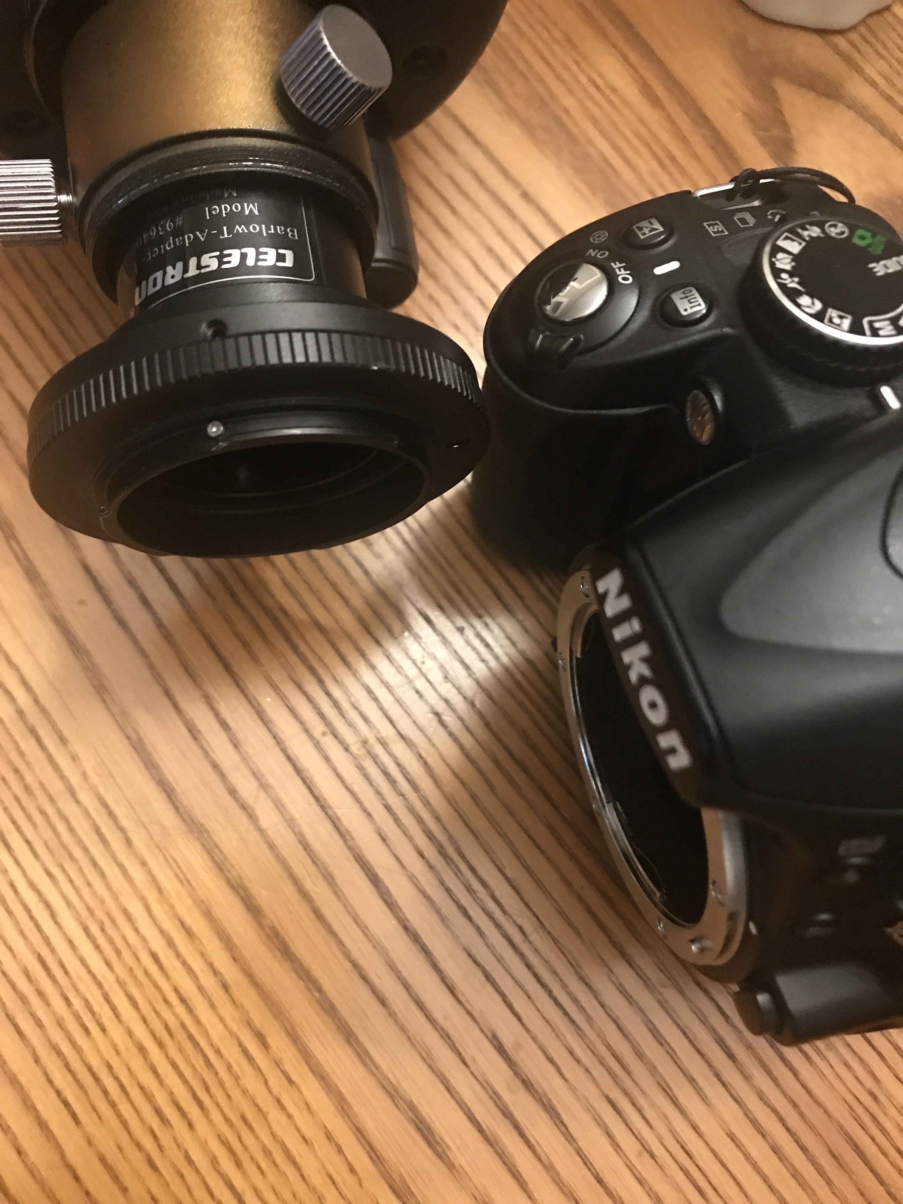

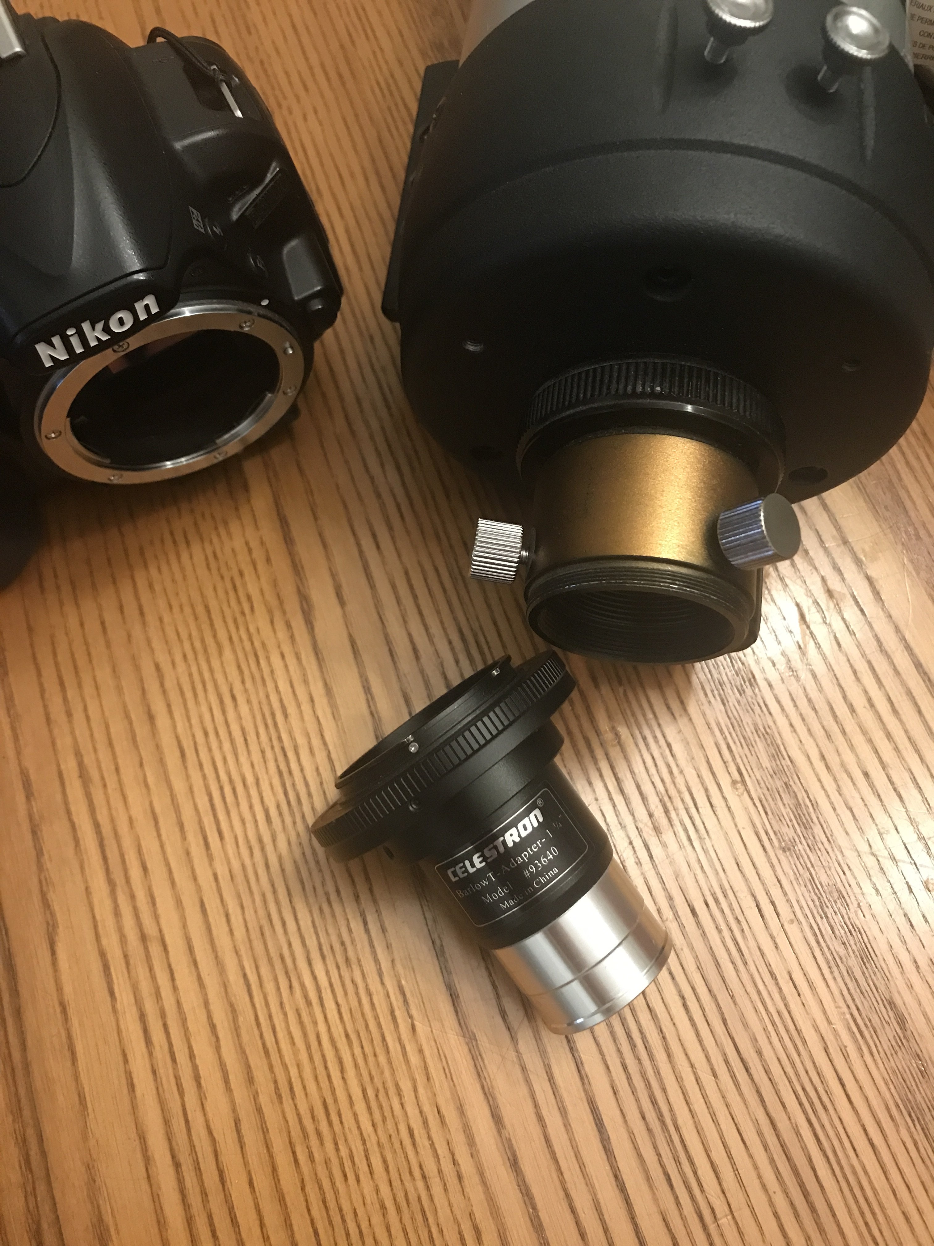

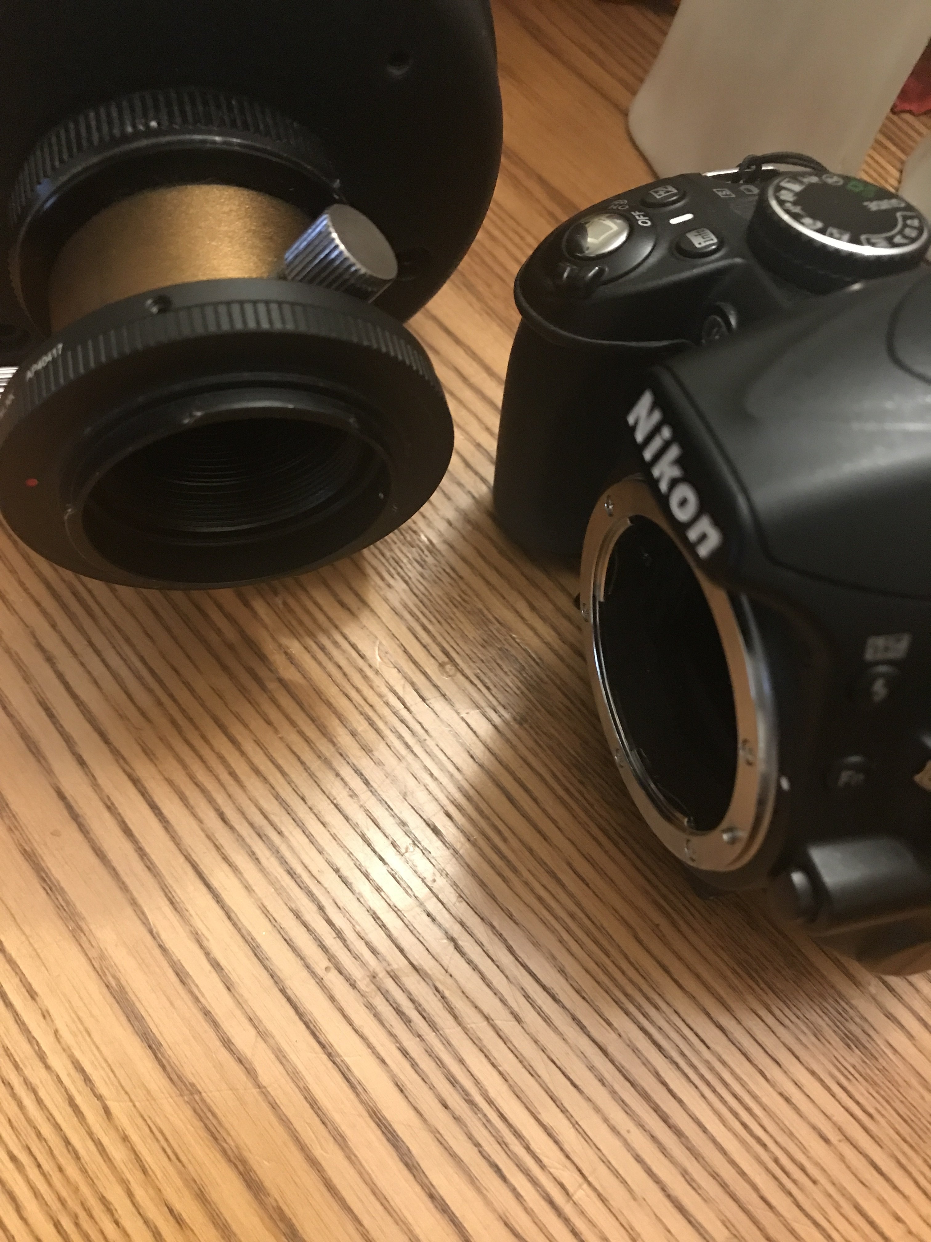

Here's my T-adapter (1st 2 pictures.)
I think I'll try just using the ring to mount the camera to the telescope (3rd pic)...I don't know if the length of the T-adapter affects the focus at all.
I have taken off the camera strap. I'll also try 2 and 10 second timers.
