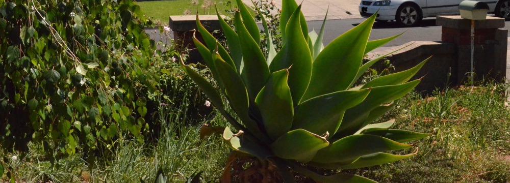

thanks everyone. Here's a photo I took (the car happened to be driving past!) in Shutter mode, 1/4000 with me bumping the ISO up to 6400. On 1/4000 I was still getting the 'subject is too dark' message and it only stopped (I think) when the ISO got pretty high. I've cropped the photo down, just to edit out my neighbours and their houses :) Otherwise it is untouched. The EXIF data (according to the Gimp) is * Exposure time: 1/4000 sec * F number: f/14.0* ISO 6400
Why F 14? If you want to use a fast shutter speed you might want to consider opening up your diaphragm to lower the iso values... And for a static subject, depending on the lens used, 1/4000 is a bit too fast. You have to make a choice and you can't get it all: Low iso, super fast shutter speed and F 14 is a LOT to ask from any camera system...
It appears to me you are getting shots that are too dark because your settings are simply not a good combination for the environment you're shooting in and you're asking you camera to do the near impossible with those settings.
For static subjects, like this plant, think shutters speeds of around 1/60 as opposed to 1/4000. For slow motion, such as people moving at walking speed, bump your shutter speeds to around 1/250 or thereabouts. For faster motion (athletics, etc.) think 1/500 or 1/1000. These are just guidelines, mind you; they're not meant to be interpreted as hard and fast rules.
For aperture, f/14 is a bit deeper than what you probably need for this shot so I'd suggest you open up to, say, f/4 or f/5.6 and see how that looks.
I'd suggest you let Auto-ISO handle the rest but if you want to dial in a specific ISO you certainly can. For bright sunny days ISO's in the 100 to 300 range will be fine. I'd save mid-range ISO (400-1000 on your camera) for lower light situations and high-range ISO (anything above 1000 on your camera) to very low light situations.
Remember that exposure is a BALANCING act of Aperture, Shutter Speed and ISO. The trick is using the right combination for the scene you are trying to capture. Use what you need, maybe a little more, but not too much.
aroy
Best method is to set the mode to "A", and check what speed you are getting. Too high an aperture will not only require higher speed (at a given ISO), but have a lot of softening due to diffraction. Here are steps to get reasonable images, which are well exposed, using the settings from your image :-
Your settings are
. ISO 6400
. Speed 1/4000
. Aperture F14
. Now reduce you Aperture to F7.1, ISO required is reduced to 800
. Reduce speed to 1/1000, ISO required is reduced to 200, that is manageable
. If you use primes and shoot at a distance, then even F1.8 will give to sufficient DOF. A 24-70 F2.8 or a 70-200 F2.8 used at F2.8, will let you increase the speed more than 6 times over F7.1, so you can use ISO 100 outdoors.
Except for Macros, where DOF is extremely shallow and extra DOF is preferred over diffraction free images, avoid using apertures of more than F8 in normal shooting. The exceptions are situations where the light is extremely bright and lower shooting speed is desirable. In that case it is better to use higher F stops, rather than blow the highlights.

I've shot hummingbirds in flight and not felt the need to get up to 1/4000s, so that's the heart of your problem, as has been said. Aperture? At 29mm you're going to get everything from 5 feet to infinity in focus at f14, and only need to shoot at 1/60s or better to prevent movement and could likely render just about any movement unseeable at 1/500s (guess).
Get a handle on exactly what each of those 3 settings does for you and then work from the most important factor to the least for the shot.

Thanks everyone! I didn't set the aperture as I was in S mode and the camera adjusted aperture for me (I was surprised to see f/14 in the EXIF data as it was f/7.1 on the actual camera). The photo shown was in S mode and was an example of how high I had to set the ISO to take a photo that didn't give me the 'subject is too dark' message. It's not the kind of photos I usually take, it was just an example for this thread :)I only ever use A mode and I have no problems with that-- I'm only asking this question about 'subject too dark' because it only happens in the S mode and I was surprised it was happening on a bright sunny day. Plus I wanted to practise with S mode for the weekend but will stick with my A mode! Thanks for all the replies, I appreciate the time taken to reply!
Check if you have set ISO to "Auto ISO". I used fixed ISO, mostly 100 outdoors and 400-800 indoors. In S mode, especially with default "Auto ISO", some settings increase/decrease the ISO and then the Aperture, while other setting do the opposite. Another setting to take care of is the Aperture set on the body before switching to "S" mode from "A" mode. At least in my D3300, the Aperture set is the minimum that the auto ISO uses, it will increase the aperture if the scene is too bright, but will not go below it if it is dark. That must the problem in your case. Here is what I think the settings were
. The aperture set at 14, before switching to "S"
. ISO set at "Auto" by default
. Max ISO set to the default 6400
To be doubly sure, just check all the setting, and then switch off all the "Auto" settings.
