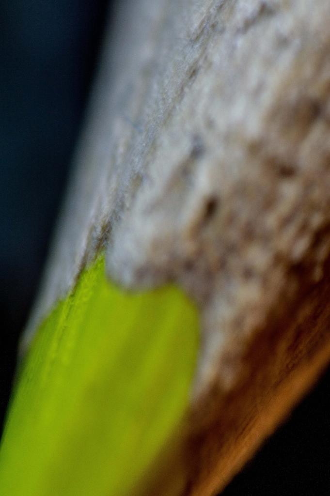

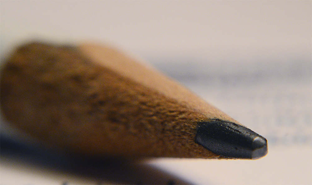

I took these pictures using a reverse macro ring, with the 18-55mm lens on a D3200.
1st picture set on manual about 3 inches away from the subject.
lens at 55mm, iso 200, no F info
The second picture, same setting, but the lens at 18mm, so try and set your lens at 55mm and about
3 inches away.

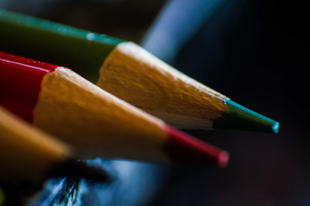

Here's a shot I just did with the 55 1.2 at f4 with the reverse ring. A few tests for exposure and then just some color correction to overcome the color cast of my light.
