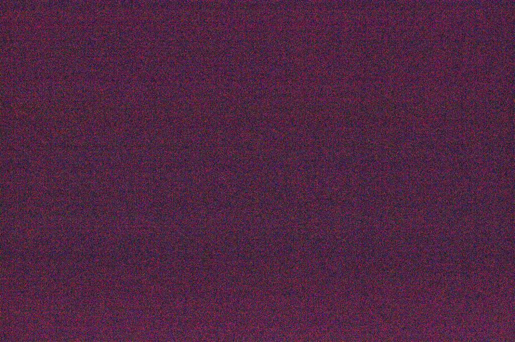

Hello all,
I was hoping I could get some help in figuring out what is going on here with my photos? I am very new to photography. I am trying to take some decent photos of the night sky, but they keep coming out very noisy and/or with hot pixels. I bought my Nikon D3100 used at the beginning of july , but it only had about 2500 actuation's on it. I know that with this beginner camera I should not expect results like a pro, but the photos are very grainy and seem to have a lot of hot pixels. I have read to take care of this problem in post processing but I seem to have trouble doing this. I downloaded a hot pixel mapping program for post processing but it does not seem to think I have hot pixels. I took a long exposure photo at a high iso with my lens cap on for this program to map the pixels, I will provide that photo so the results can be viewed and maybe some suggestions can be given. Thank you in advance for any assistance with this.
P.S. I just re read this post, and just to make it clear I am asking for help with determining whether or not if I have a bad hot pixel issue or bad noise issue.....................thank you again
here is the Exif from the raw photo
exif.make=Nikon;
exif.model=D3100;
exif.artist=;
exif.date_time=2014:08:06 01:46:18;
exif.date_time_original=2014:08:06 01:46:18;
exif.date_time_digitized=2014:08:06 01:46:18;
exif.exposure_time=25/1 sec;
exif.ISO_speed=ISO-1600;
exif.f_number=f/3.5;
exif.focal_length=18;
exif.color_space=1 (sRGB);

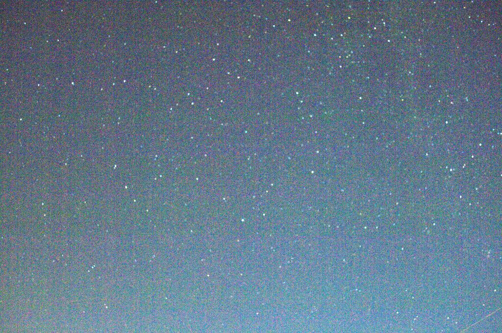

I dont crop at all, and I am very aware that this is a wonderful camera and very capable, but as I have asked this question elsewhere I have been told by others not to expect much from a beginner camera, so i was trying to avoid useless information by saying I new it was a beginner camera, that way I might get help with noise/ hot pixel issue I have. I downloaded a program called hotpixelfixer which maps the hot pixels but it didnt seem to find any hot pixels. I have tried shooting at iso 1600 for 30, 25, and 15 seconds, and at iso 800 for the same amount of seconds and 400 for the same amount of seconds. here is an actual photo I took of the stars and here is the exif data for the photo...............................I am just looking for help with the best way to process this, and / or if I have an issue with hot pixels/noise
exif.make=Nikon;
exif.model=D3100;
exif.artist=;
exif.date_time=2014:08:04 23:17:17;
exif.date_time_original=2014:08:04 23:17:17;
exif.date_time_digitized=2014:08:04 23:17:17;
exif.exposure_time=15/1 sec;
exif.ISO_speed=ISO-200;

I'm far from an expert but that looks like high ISO noise to me. I used to get noise like that on my Olympus cameras at higher ISOs
I was referring to the first photo you added, not the new one you added while I was typing :D

Looking at the settings you used for the image posted
ISO 1600 and a 25 sec exposure at f/3.5
I can't see any hot pixels but there is considerable noise which is not uncommon at these kind of settings.
I would keep the ISO below 800 if possible even lower. Also cover the eyepiece for the viewfinder as you do get light leaks from there.
Have you tried talking multiple shots at say 10 secs each at ISO 400 and then stacking them?
As Mike asks how much do you crop because you can reduce noise in down sizing the image.
You can also get software that reduces noise as well but that starts to up the cost

There are a couple settings you should examine on your D3100: Noise Reduction and Active D-Lighting. The first option you want enabled (it's disabled by default) and the other you want disabled (it's enabled by default) for this type of long exposure, night-photography. Both of these options are in the "Shooting" menu (camera icon) of your D3100.
Enabling the Noise Reduction feature will, somewhat obviously, help reduce noise so you want this option turned on. The second option, Active D-Lighting, attempts to balance high contrast scenes and does a good job but at the expense of increased noise in the shadows. You don't need this sort of correction, or added noise, when shooting at night so you want to make sure this option is turned off. For shooting in daylight you may want to re-enable this feature.

I think this was discussed a week ago, still here goes.
To shoot night sky you need low noise, but long exposures increase the noise a lot, so does higher ISO. Here is a method used by Astromomers
. Use ISO 100
. Use your lense wide open
. Use a lot of 1 second or less exposures, taken one after another. Instead of 30 seconds at ISO 1600, which translates to around 30*16 = 480 sec at ISO 100, take 500 shots at 1 sec, one after another. Then merge them using software. The advantage is
. There will be less thermal noise in each shot.
. Minimum noise at ISO 100
. While merging the noise decreases as square root of number of shots
A Look at Reducing Noise in Photographs Using Median Blending
Sharp low-noise photography using multiple photos
