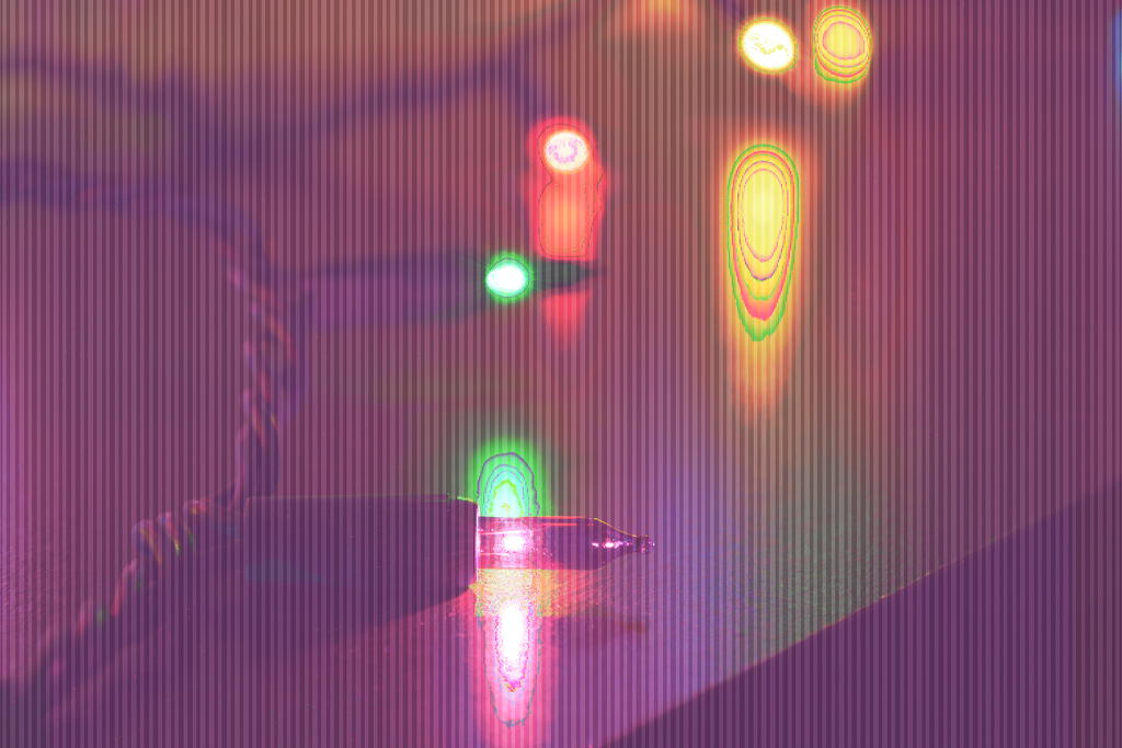

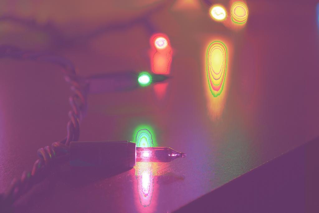

I am facing a weird issue with my Nikon D5200. I have started to see grains in the Live view and in the pictures. Have attached 2 sample pic.
Generally when I start taking pic the initial 15-20 pics come fine. However suddenly the grain/lines start showing up on the live view and on the pics. I have tried to blow out dust as well as tried the "Clean image sensor" from the menu, but no success.
Has anyone faced this issue before? Or has idea how to fix it?

Welcome to the forum,no idea about your problem unless its related to the type of pictures you posted,does it happen with normal exposures.
Are you saying that the shot is grainy? The two shots you showed us are extremely underexposed and will always be grainy.
We need information on how you are shooting. What ISO? What mode? Auto? Manual? RAW or JPEG?
Post the EXIF data with a photo that you shoot outdoors in the sun.
Well the images were shot at night. ISO 100 and stutter speed of 2-4 sec. I did get some pretty clear pics as my objective was to get the light bulbs in dark. But then the grain/lines stared showing up. The grain you are seeing are not due to ISO. Had tried one with flash as well but similar result (Have deleted that else would have uploaded that).

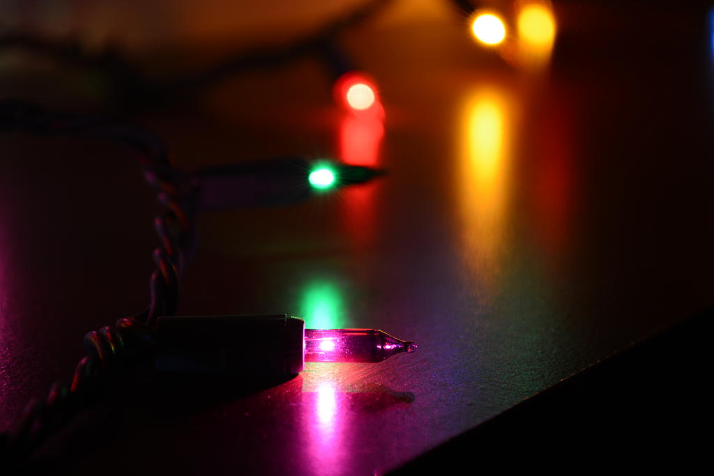

Here is a pic to compare before the grains showed up. Same/similar ISO, exposure and shutter speed.

The grain is due to under exposure. The camera is trying to expose to get the dark area visible. You need to cut the exposure I would bet the exposure on the last shot is less

Do you have spot or center metering on? If, when you focus on a light source, the cam tends to darken out the rest in an attempt to normalize the light.
Edit; just checked the before image. That's different indeed. Grain shouldn't pop up for no reason if the settings remain identical.

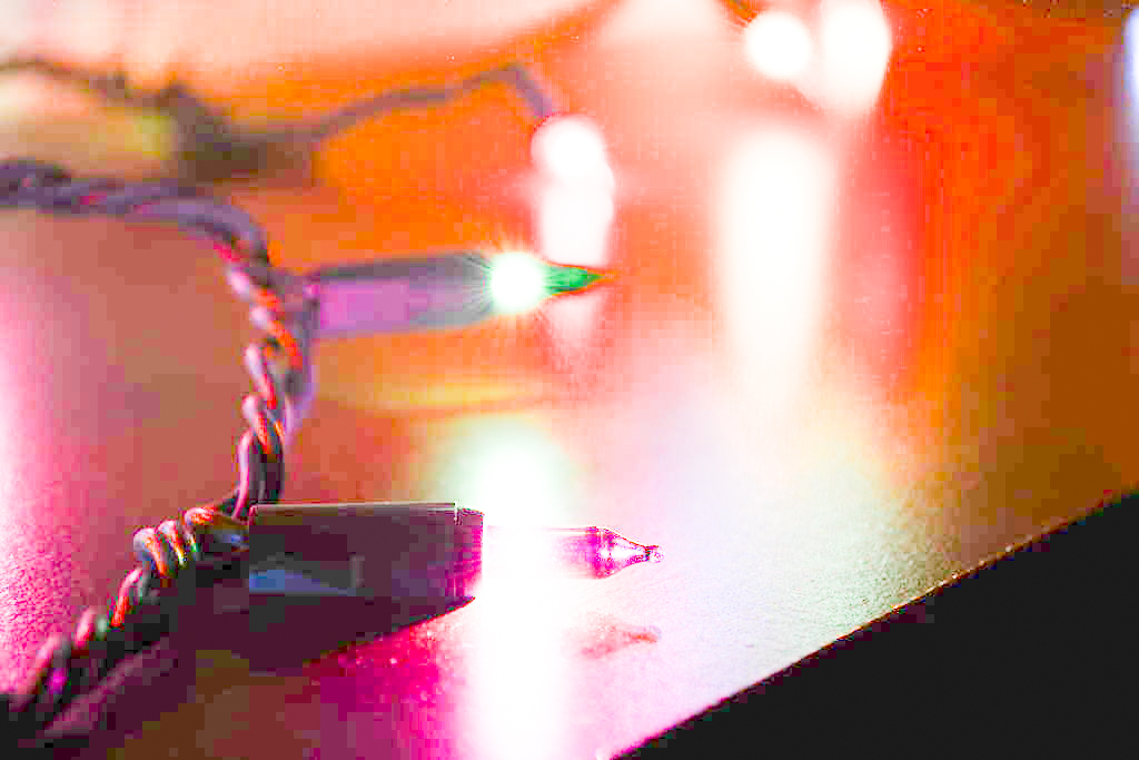

I overexposed that correct image in LR by 5 and it's not identical to your grainy ones so I doubt it's just overexposure:
J-see
The only manner to somewhat get a similar image is when I start messing with the cam calibration in LR. Not sure if something goes on there but what I do know is that the blue channel is related to noise and the higher you push that, the more any noise will become visible.

I can understand the grain part in night. But greening of pics and lines/grain appering in pics and also the flickering/lines on the screen while trying to shoot. Thats very odd. In my past 6 months of using the cam this never happened.
I will be shooting tomorrow during the day and share the pics.

If you shoot identical pictures, they should remain identical. If suddenly they fall apart in noise without you changing settings, it can't be else but the cam having an issue. There's also hardly any contrast in those shots and it's as if you killed all shadows too. If you're not doing any of that, somethings going wrong in the cam.
I'd put the cam on a pod and start shooting the same shot. If it starts goofing up after x amount of shots, you might not know what it is but you'll know for sure there is something wrong and how to replicate it so they can get it fixed. You best know exactly when it fails when you send it in for repairs -should that be needed- else you might get it back with a "could not replicate" note.
To add: if your warranty no longer covers eventual repairs, it would maybe be a good thing to first ask what it'll cost before sending it in. If it should be the sensor or any critical part, those costs could run high. But first test if it really is a cam failure.
