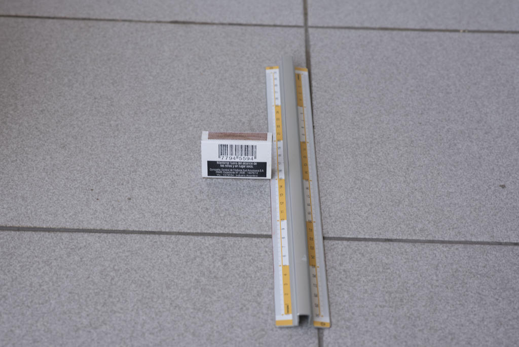

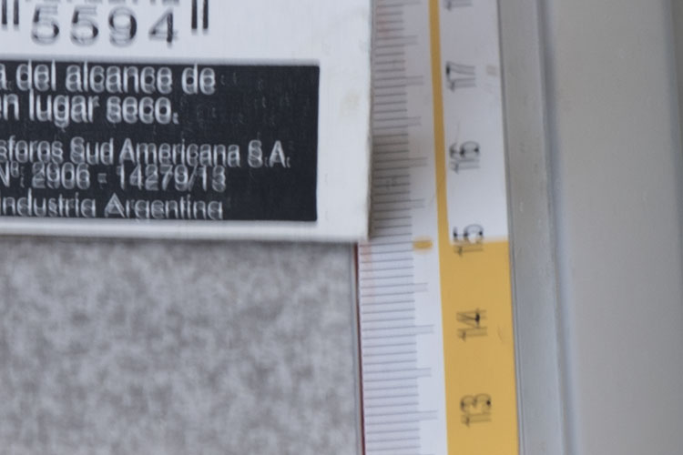

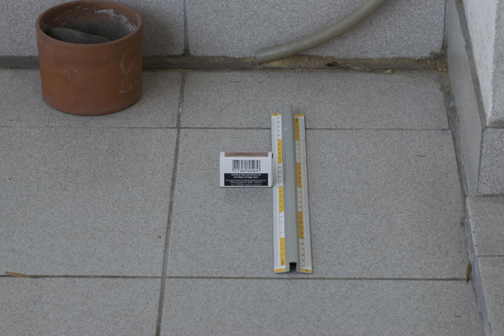

<blockquote data-quote="Horoscope Fish" data-source="post: 581051" data-attributes="member: 13090"><p>He's shooting with a Nikon 85mm f/1.8 and a Nikon 35mm f/1.8; neither lens has VR. </p><p></p><p>Further, he was shooting the 85mm at f/9; so let's wild-ass-guess a distance-to-target of six feet which doesn't seem unreasonable based on the posted photo. Using those numbers the depth of field would be about 6 inches; increase the distance-to-target to eight feet and the DoF increases to nearly 12 inches. </p><p></p><p>In looking at the posted shots, though, nothing appears in focus to me and the lack of focus just looks to me like motion blur. Obviously I could be dead wrong but I still suspect motion blur is being introduced somehow and it wouldn't take much of it, at all, to blur a shot to that degree considering the shutter speeds involved. I'd like to see these tests repeated with shutter speeds that <em>at least</em> equal the focal length being used for the D750; e.g. 1/125 for the 85mm.</p></blockquote><p></p>
[QUOTE="Horoscope Fish, post: 581051, member: 13090"] He's shooting with a Nikon 85mm f/1.8 and a Nikon 35mm f/1.8; neither lens has VR. Further, he was shooting the 85mm at f/9; so let's wild-ass-guess a distance-to-target of six feet which doesn't seem unreasonable based on the posted photo. Using those numbers the depth of field would be about 6 inches; increase the distance-to-target to eight feet and the DoF increases to nearly 12 inches. In looking at the posted shots, though, nothing appears in focus to me and the lack of focus just looks to me like motion blur. Obviously I could be dead wrong but I still suspect motion blur is being introduced somehow and it wouldn't take much of it, at all, to blur a shot to that degree considering the shutter speeds involved. I'd like to see these tests repeated with shutter speeds that [I]at least[/I] equal the focal length being used for the D750; e.g. 1/125 for the 85mm. [/QUOTE]
