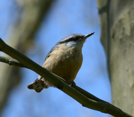

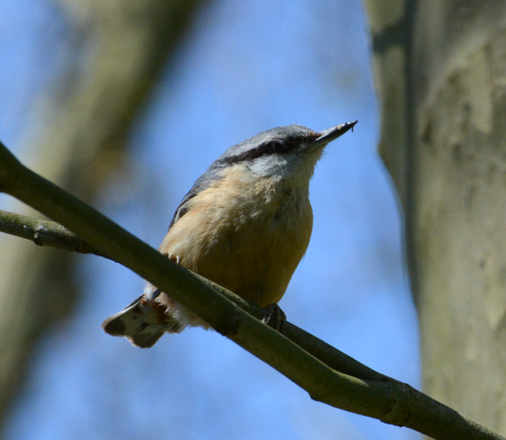

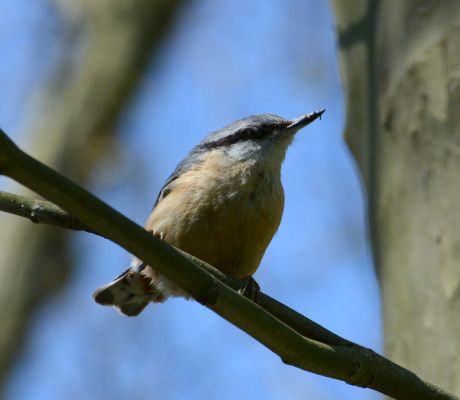

Thus, i blew the shot. see below:
the contrast is awful. I do not know what to set in the camera to make this a beautiful photo.
Could someone please tell me how to get this photo correct?
i know where to find the bird and i'll go back tomorrow. it is nesting and i will have more chances for photos.
I have a Nikon D5200 with a 70-300mm lens.
Thanks.

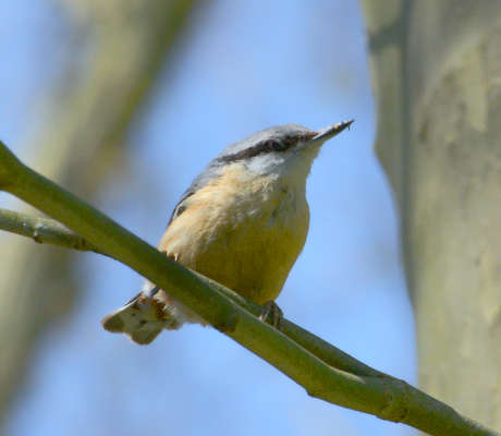

You haven't given me much to work with here as it's a low res jpeg, but in about 60 seconds I went from your shot to this...

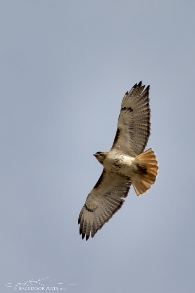

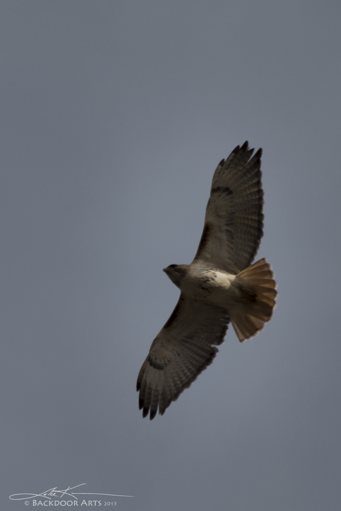

Here's a Red-tailed Hawk the flew over, as it came out of the camera...
Decent capture, but dull, full of shadows, and sort of lifeless.
Here's the same shop editing only in Lightroom, which would be equivalent to Adobe Camera RAW.  Nothing special, no gradient or brush adjustments...
If it were a better shot I would have sent it to Photoshop and tweaked away, but this was good enough for what I need and a hell of a lot better than the straight out of camera shot.
